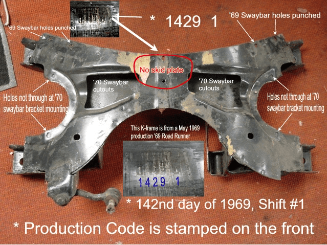

perhaps get the date codes off a few parts that hopefully are original to the car... Like the K member...
I went out there and cleaned up that area of the crossmember but can't see any numbers. I may try again later and clean a little further back. I only concentrated on the first couple of inches, but that circle above goes back more than I cleaned.
The red circle in that image isn't where the date code is stamped - it's only there to call attention to the lack of a skid plate. The stamped date code is actually on the front-facing vertical surface of the K-member - it is not visible in the attached image but is roughly 'pointed at' by the white arrow. There also may or may not be a welded-on "coin" (a small, thin metal round or ob-round plate) bearing the last digits of the K-member's actual 7-digit part number stamped into it on that front surface.

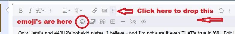

If I knew how to do emojis I would do the one where I am slapping myself in the forehead. My car is apparently missing a skid plate. There is a bolt in that top hole but no plate. I will check the actual area for numbers. Thanks.

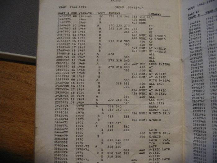

Only Hemi's and 440HP's got skid plates, I believe - and I'm not sure if even THAT's true in '68. Bolt is likely for the brace that goes from K-member to bottom of core support - maybe that is MIA on your car? I'd have to go look at the parts manual to know there's supposed to be one in the first place. Me working "from memory" is always sketchy!:D (Image below is a guide to the emoji's)
Thanks for the tutorial, Mark.:thumbsup: There is a brace there. They put it there to keep people from being easily able to scrub gunk off the area where the K member is stamped. I found numbers...
72 681 Now to figure that out.

...looks more like a vendor code...
Would concur. Even IF that 1st digit was a crazy-stamped "1", that's May 5 '68...probably later than the current speculation of SPD.
So clean a bigger area...

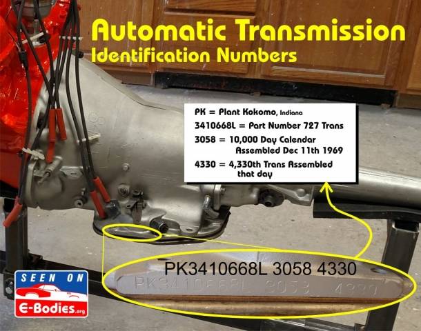

Yup - to the left and the right ...and - @fesser ; while you're rolling around on the ground, you might as well get the transmission numbers, too. Might be more clues there. Reference image attached if you're unfamiliar with those - the format is much like the engine numbers on the pan-rail ear by starter.
