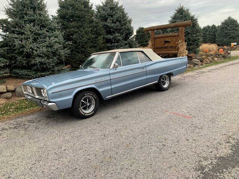

I have 14x5.5 and 215 70 in the front and 15x6.5 and 255 60 in the back.
73 Satellite- not quite as much as exposed wheel area as you but close.
Looks like it should have come that way from the factory.
I know the 255 is a size too wide for the 6.5" wheel but it looks fine and does not wear unevenly No issues mounting either.
I'll have to dig for a pic with a good angle.

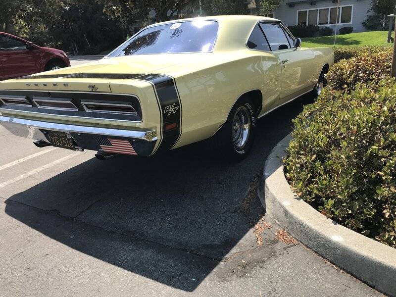

14 front 225/70. 15 rear 295/50. Only pic i could find. Drives great. Looks good.

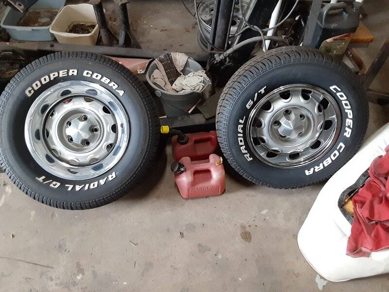

Here are the actual wheels and tires-

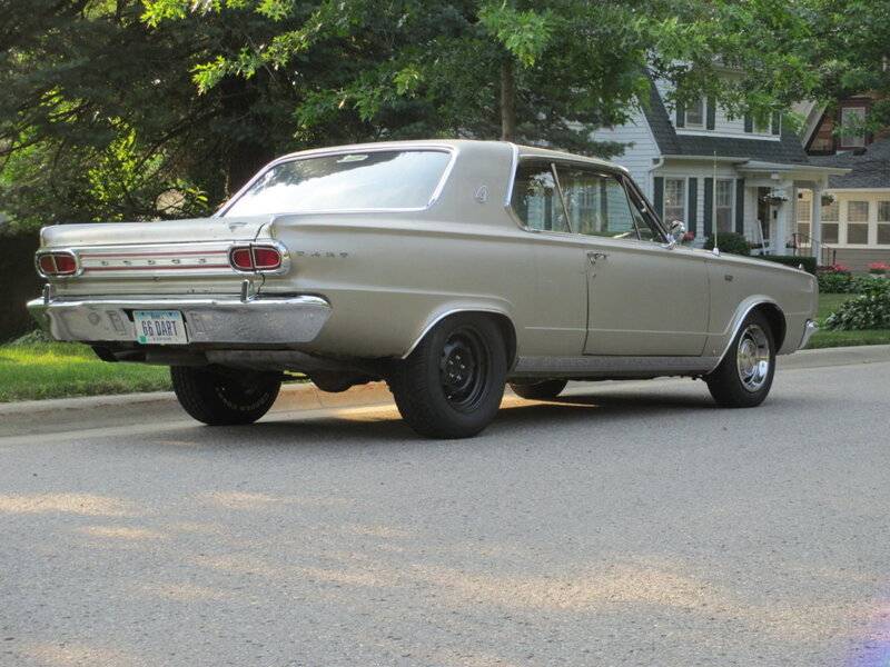

I know I know, not a B body. Both mine run 14/15" combination. The Swinger has 205/70-14 and 255/60-15's
