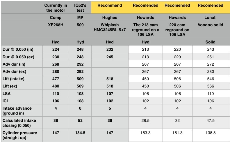

This is great input, guys, I really appreciate it. My take away here is those cams are not slam dunks, so thanks for setting me straight.
Regarding the negative affects of aluminum, well you guys got me there. I'll tell you what, I'll go with whoever wins the argument lol.
Now, regarding my budget - I have about $4k this winter / spring for the whole car. Anything I don't spend gets saved for next year's budget:
$700 gears (figuring I'd sell my setup)
$0 converter (I have a 2800-3000 stall ready to put in)
$200 used rpm intake (or other decent dual plane)
$0 ductile iron rockers (already have the setup)
$200 or so for pushrods and incidentals
$1100 that should dramatically improve performance and drivability.
That leaves me with about $3k to work with.
Again, thanks for the input. Without it, I'm sure I'd just build another mismatched pig.

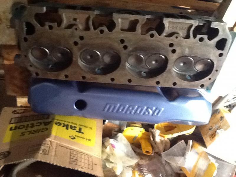

Well, I'm officially out of the aluminum vs iron debate. Just picked up some 915 HP heads last week. Petty psyched about em. They have the big exhaust valve and look like they may have had some bowl and port work done. Bonus, they even came with valves. I had em checked over by the guy doing my gears (old school mopar guy) and he said they look pretty good.
While I was there, we made a nice deal on some steel shim gaskets and a oem timing cover (can't stand the chrome one I have). He threw in the valve covers you see there, which look pretty neat.
Now I gotta save some cash for an RPM intake. Anyone have one lying around? Maybe trade for my Torker2?
(Not sure why the picture posted upside down?)

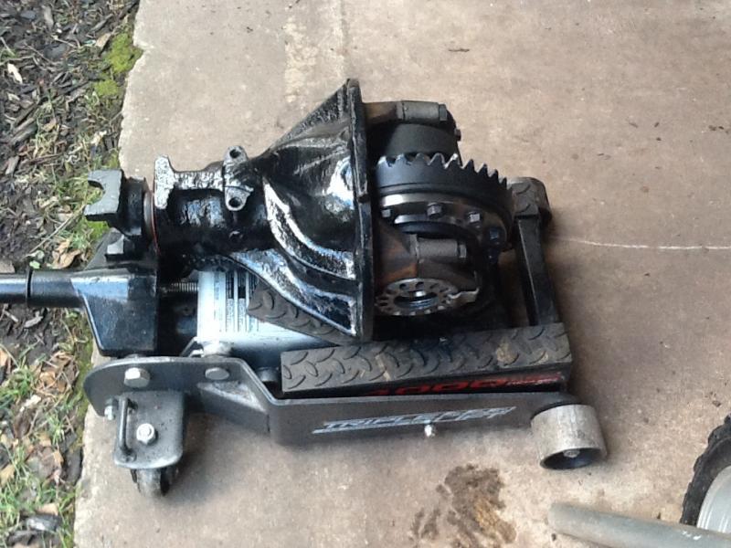

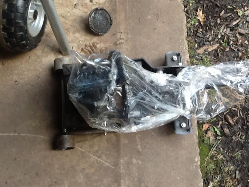

Got my gears!
My buddy Ken set up my new gears for me. Took my 489 case, installed the crush sleeve eliminator and some 4.10's.
Bad news is i needed a new auburn unit, as the other one was trashed. Amazing that the trashed unit could still lay 2 strips with my 30"x12.5" ET street radials.
Next up is the converter. Should start it up tomorrow if i'm lucky.
