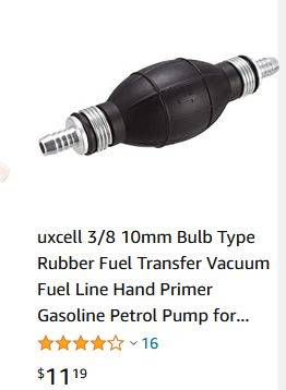

If you left filter off for a few hours may have lost oil to seal pump. It happened to me, pulled pump put some thick oil it and that fixed it. Was told you could pull oil sender and fill through there. if you have and other things like a bulb pump.

How would you reprime pump? Like to hear other ideas. Didn't have priming shaft available. Start engine the no oil pressure in 30 seconds I shut it down. I suggested with bulb pump prime through oil pressure switch holes, that the only way I can think of. When it happened to me I think less a act first:rolleyes: pulled pump as he did . Those bulb pumps are handy to have.
