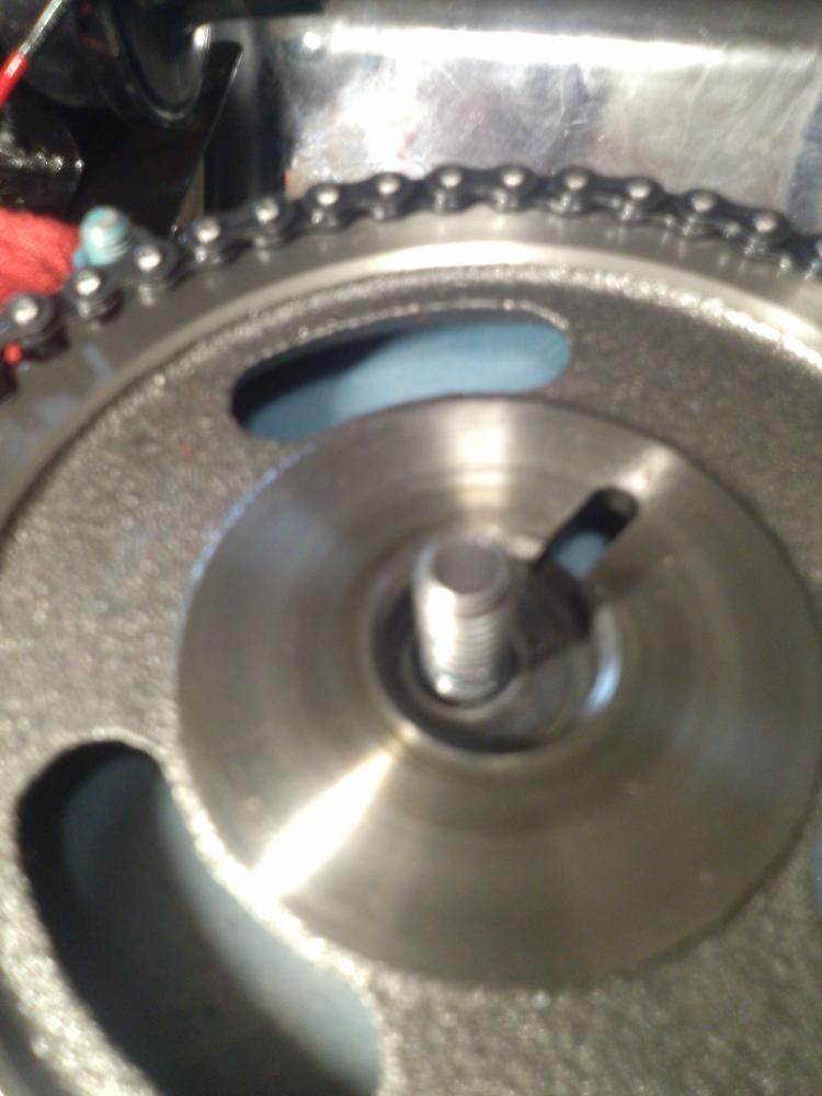

Heres the timing set off. No marks on the block or cam gear to speak of. Another dead end. Also checked the freeze plugs, all snug. Nothing seems to be rubbing.

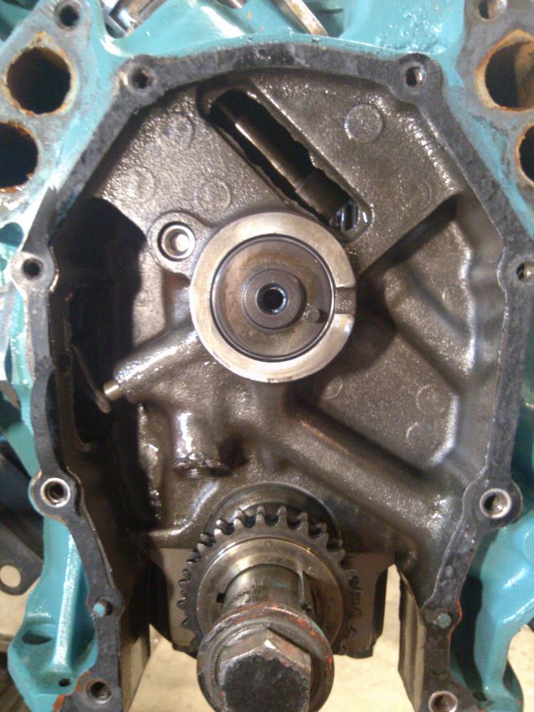

View attachment 144003View attachment 144004
Cam gear looks fine and so does block face. Was the oil slinger hitting or on backwards?
NO\o slinger shoots me down lol, however do you have shots of the back side of the timing chain? I ask because there looks like chewed up bubble gum on the lower plug near the fuel pushrod. maybe chain gear to cam not flush and hitting edge of block there making that hideous screeching noise? and PS get an oil slinger, and while you have the block apart cuz you will be rebuilding it now with those messed up bearings clean off the excess casting in front there at the distributor shaft not a big deal but clearing out the rough metal casting will help oiling. Good luck!
The slinger oils the timing chain and the back of Cam gear. Also it splashes oil into the Push rod for the fuel pump. I hope for you that the problem is this. You will have to replace the front seal and the timing chain is their is any sign of wear or discoloration, an absolute must. Get yourself a set of coated bearings.
