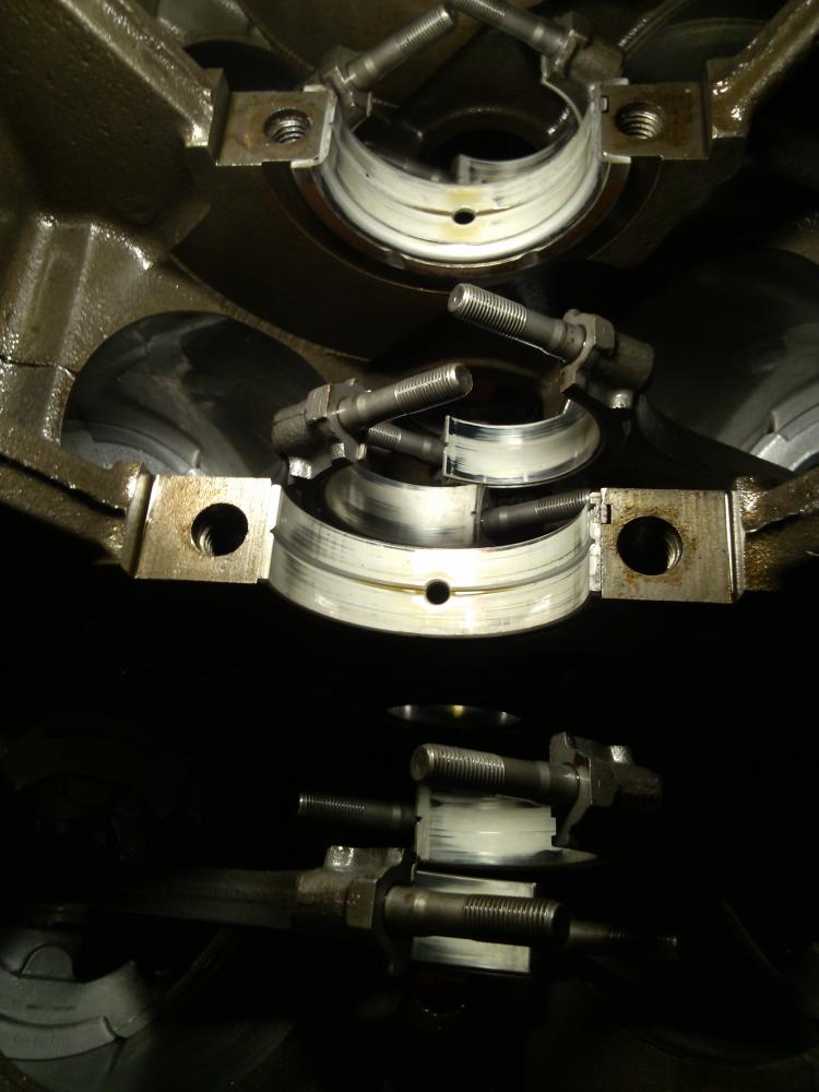

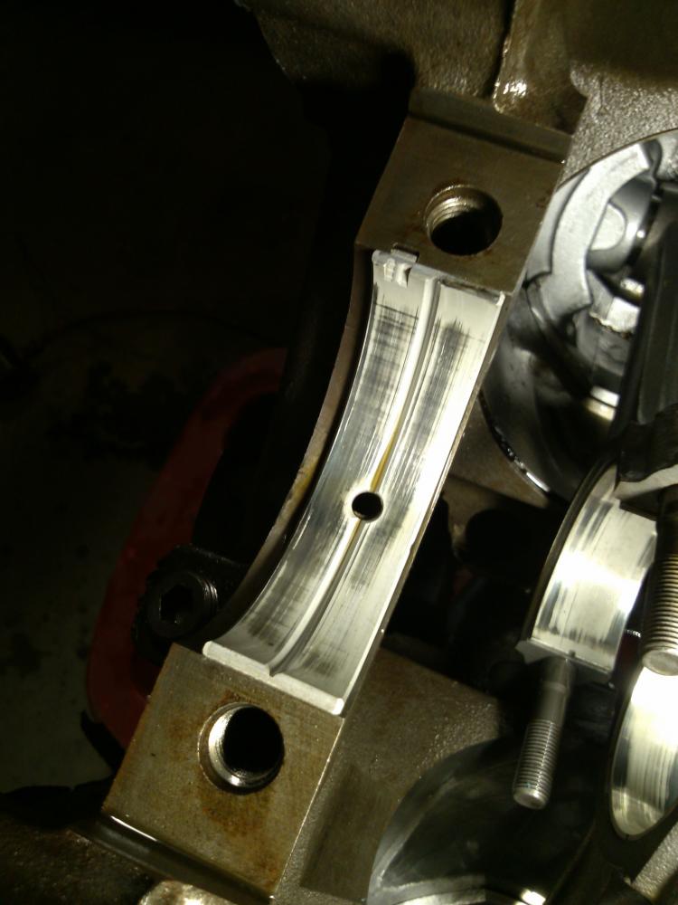

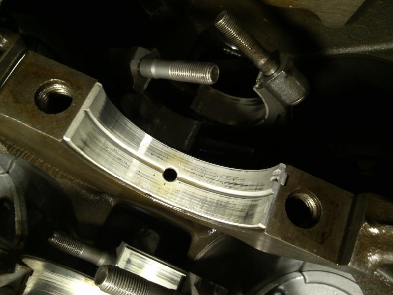

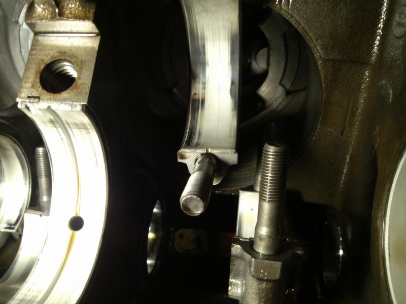

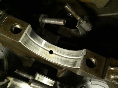

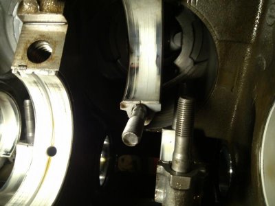

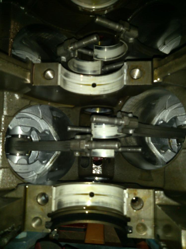

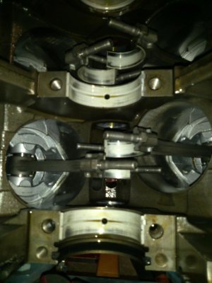

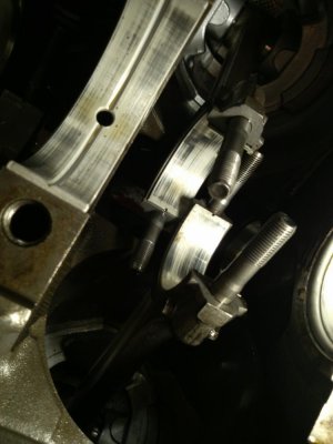

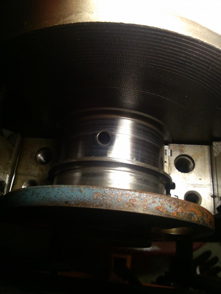

Seeing the new pics of your crank. Are you saying the crank journal is out-of-round? Or the crank itself?
Sure, polishing ALL the crank journals can be done, and help. Could even help straighten out a out-of-round journal, some. Depends on who's doing the polishing.

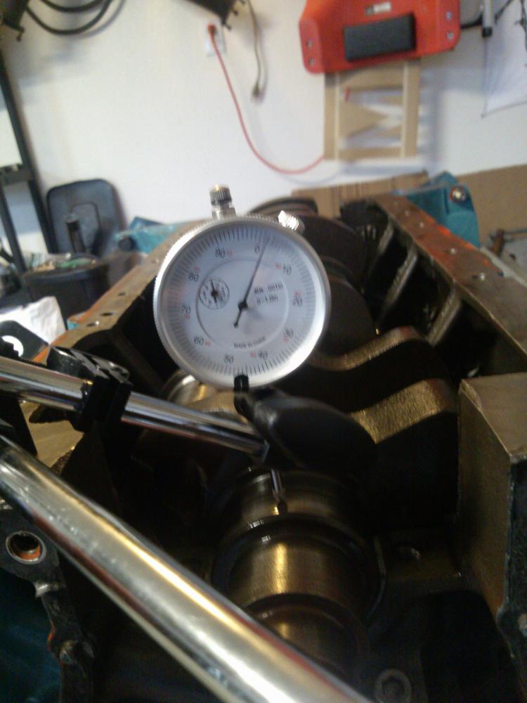

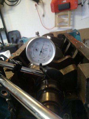

Have you been able to check if the journals are straight?
If the crank itself is bent...different story.
Any idea what kind of clearances you had...or will have?
Great hearing your getting those things found. Last...sounds...make sure you've got end play on all parts and pieces. Still think something was binding.
