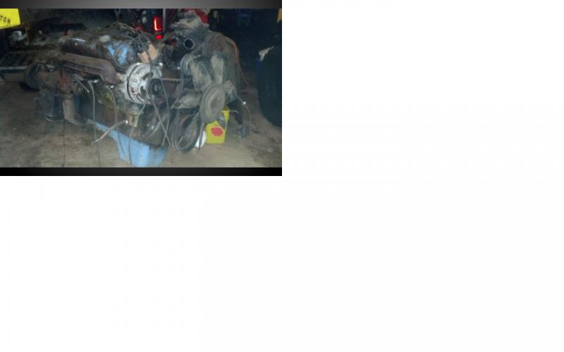

Hello!
I just purchased a strong running 1972 440 that only has 68K original miles.
It was removed from a motor home.
I would like to affordably build it for the summer (i.e, cam, intake, carb, etc)
I have a set of of 906 heads that have 190/202 valves.
Any advice for a build?
Thanks!

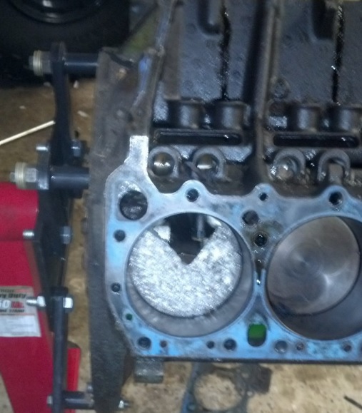

Well at first I was like sweet! A $300 complete 440.
And then I was like...oooohhhhh
Damn, that sucks. If he lied about it being strong running, he lied about it all, so now it needs to be torn down I would think. But you never know, maybe just that cylinder needs work.
A 440 can still run strong on 7! :D Hey, some people have no clue on what a strong engine is supposed to act like. There's a UPS driver that comes out here every day and his truck sounds like it's running on 3 cylinders and I asked him one day how long was he going to continue driving it like that and his response was "it's running bad?"
Stash the block and crank for a future build. No biggie
How does the cylinder bore look?
