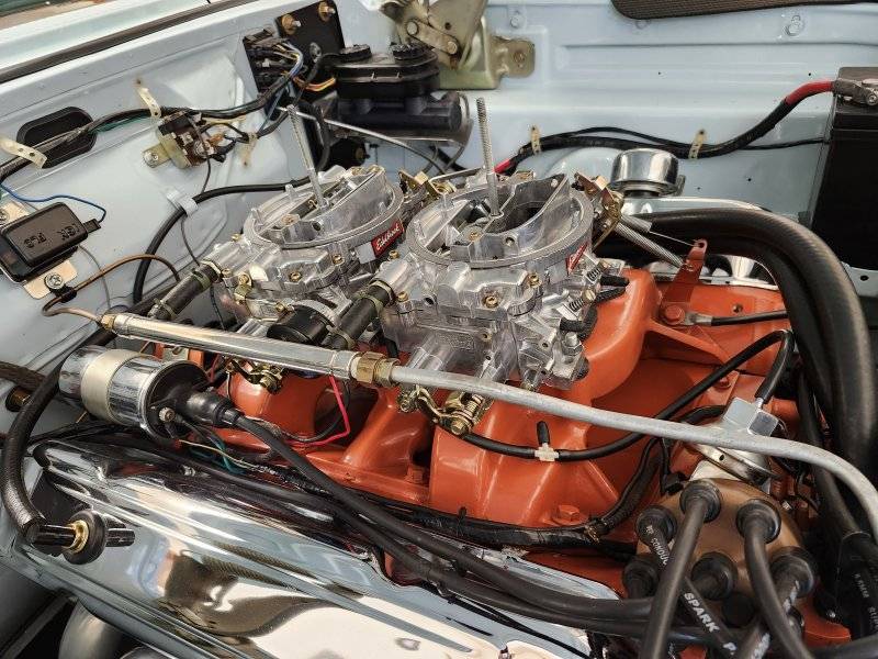

Yes I had a cross ram with 2-4's but wanted to experiment with a single 4.
