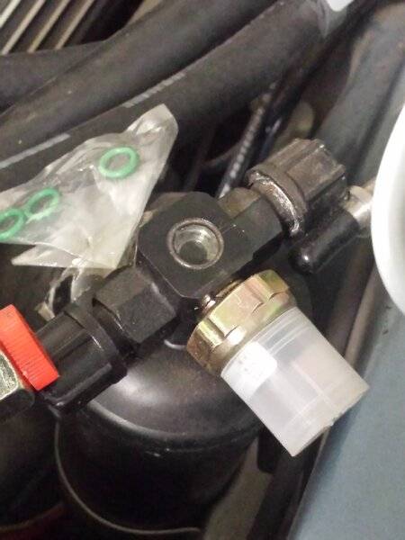

69 dodge charger question? Does the receiver drier low pressure switch get wired between the bulkhead connector and the a/c compressor? I can't find info in my factory service manual. Plus the manual shows a receiver drier without the pressure switch, that has a window/viewport... My receiver drier has a switch with the window.
Do I have the wrong receiver/drier? And don't need the switch?

Your 1969 car never had a low pressure switch, that’s why you can’t find it in the diagram.

But yes, in short, no low pressure switch 69 and earlier B body. This can have the unfortunate side effect of pulling the low side into a vacuum. If there's a leak, the system can introduce air into itself. A minute amount usually, but remember air and moisture is bad inside the system. Clean and dry is the word. You could wire in the switch, most have a sufficient deadband to prevent short-cycling. The real question is, can the switch handle the current draw of the electromagnet clutch? The FSM has the current draw figures.

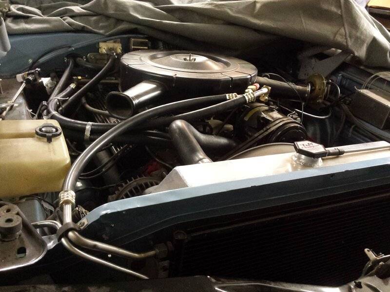

I have a v5 Harrison compressor . Its supposed to have a built in EPR valve of some sort .Semi truck application. The mounting ears are similar to the sanden compressor. And it fits great! and the double pulley belts align up nice. Been trying to find another compressor just like it but I think it's a one of a kind compressor. Any experts on the V5? Will I need the low pressure switch with the V5 ?
I have a v5 Harrison compressor . Its supposed to have a built in EPR valve of some sort .Semi truck application. The mounting ears are similar to the sanden compressor. And it fits great! and the double pulley belts align up nice. Been trying to find another compressor just like it but I think it's a one of a kind compressor. Any experts on the V5? Will I need the low pressure switch with the V5 ? View attachment 1127285
I had an Oldsmobile with automatic temperature control system....set a temp and the system will hest or cool to maintain the set point temp. The system used the Harrison V-5 compressor. This compressor is a 5 cylinder double acting design (the -5 number) and the V signifies a VARIABLE DISPLACEMENT DESIGN, using a swash plate to vary the piston stroke as the swash plate rotated. The variable device was a sort of the equilivant to the EPR valve which conttolled the swash plate angle and compressor's displacement, adjusting the suction pressure to maximize the cooling by keeping the superheat temperature at the optimal value and preventing evaporator icing. The system performed very well. As system demand changed, the compressor's swash plate angle seamless changed the displacement....IOM, a great design.....but then along came R-134A refrigerant.....and the rest is history.....
