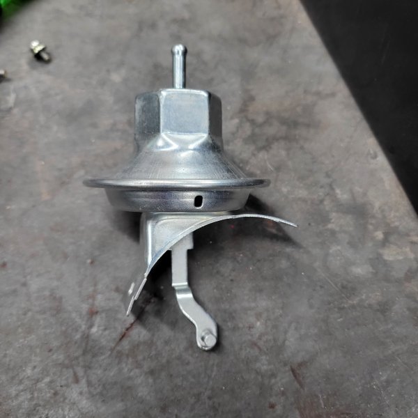

Here is what the can looks like. Would you have one that moves the arm at a lower vacuum signal. I'm not concerned with how much it moves as I can limit the travel with a shim of some sort.
Just adjust that one read above. They ALL HAVE TO BE SET!!!!!! You might have to try a few different stamped amounts to get it that low. I never had to set them there at all. I always run ported only like a mopar should usually have.
Yes, I know that. My issue is that this motor has low idle vacuum, so I need a can that with spring pressure that starts moving earlier than the normal stock can does. In a perfect world, I want one that is fully deployed around 5".

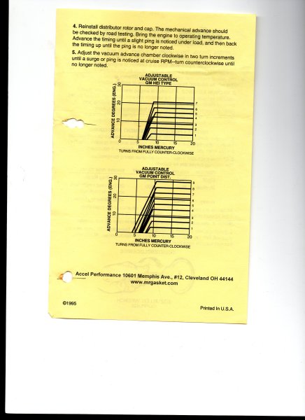

Below is the chart for the Accel adj VA units for GM dists. Not sure if Accel made one for Chrys.
I have to ask this is there any vacuum at all even a lb at the ported vac at idle?
I'm fairly certain that is the can I bought for my other car. It fits Chevy and MSD distributors. They don't make one for Chrysler however.

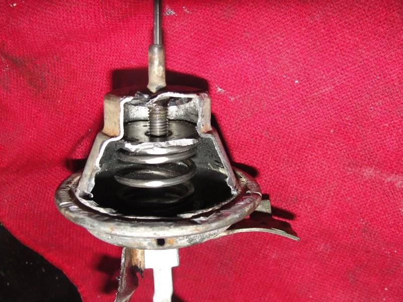

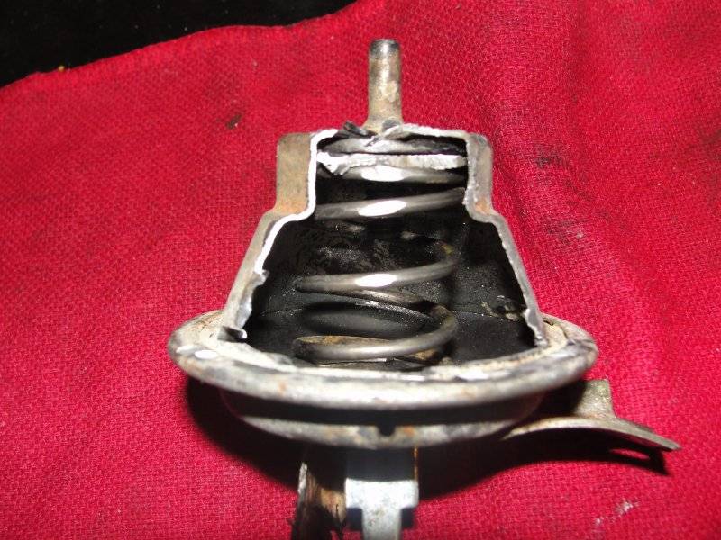

Yes, & if I remember correctly, there is a 'surprise' in store for those using the Accel or Crane adj units.
There is a spacer inside the spring that limits spring adjustment, the thing locks up. In the past, I have prised the can open & removed the spacer.
Now, I can buy a new HEI with adj MVA unit for under $100; no spacer in the VA unit.
