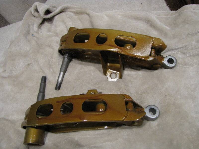

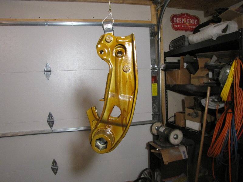

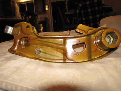

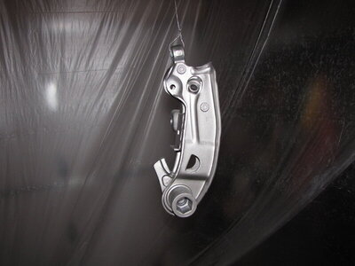

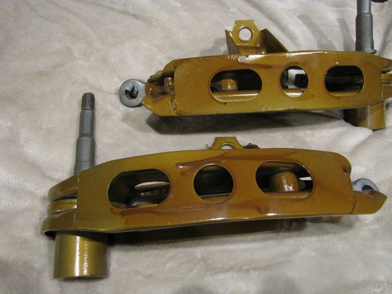

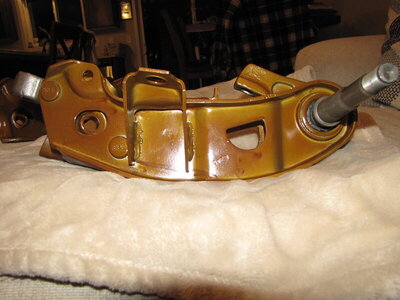

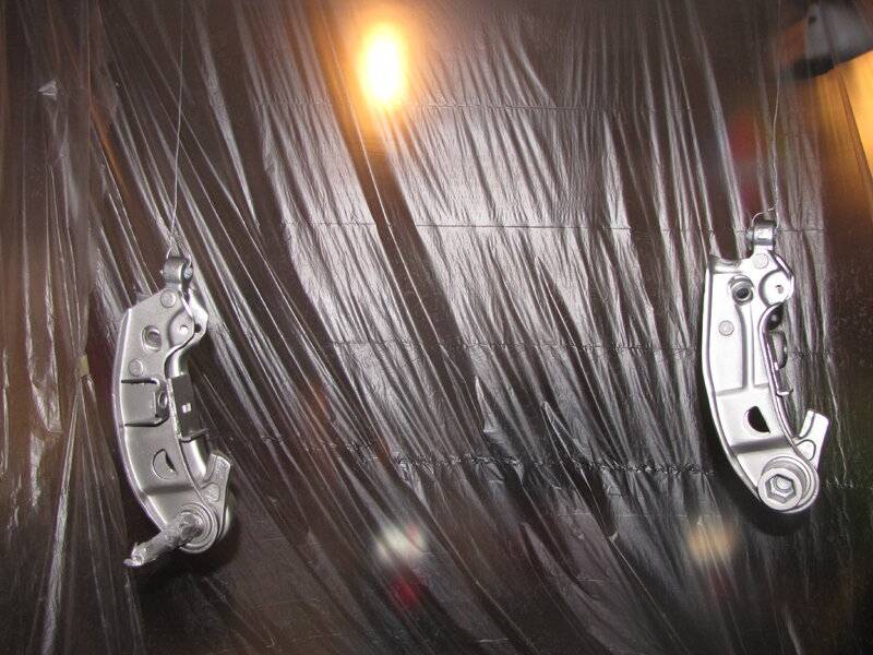

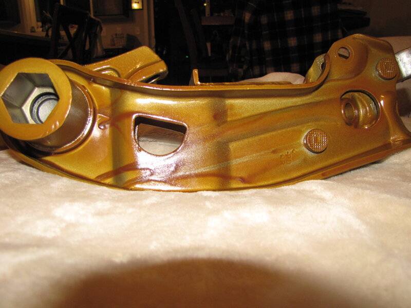

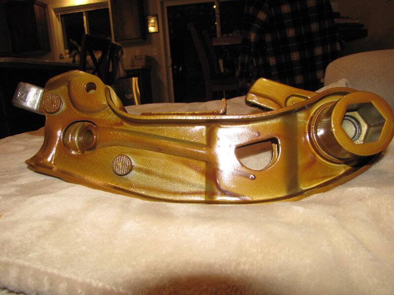

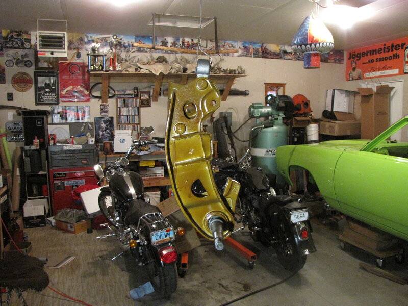

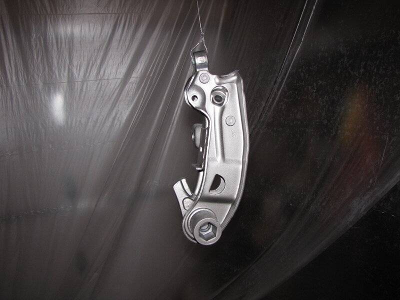

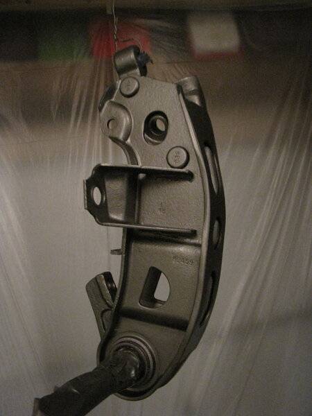

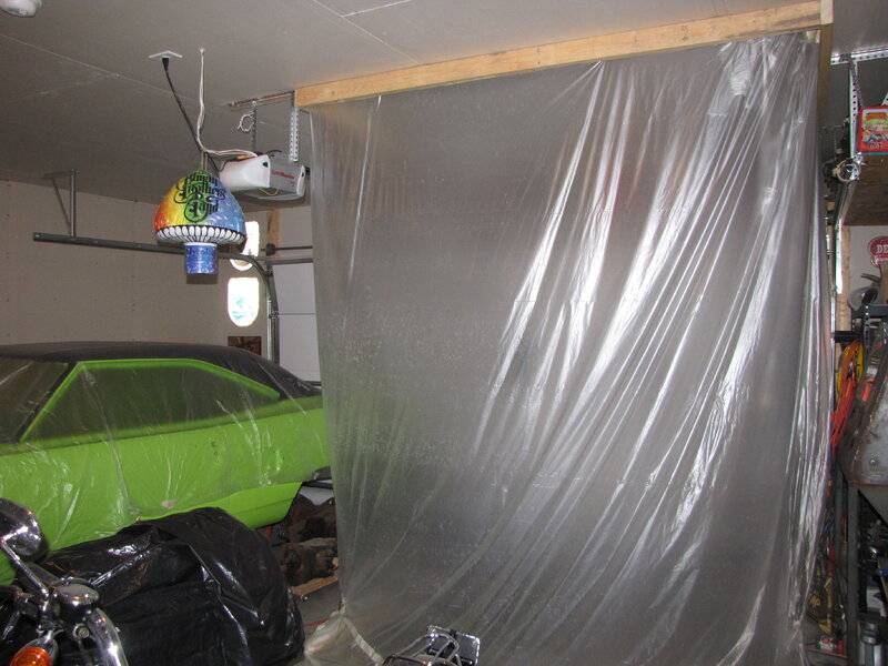

These things have been kinda hanging over my head like a black cloud and now they are done!! Woo hoo!! Of course, the bushings are a bitch to remove and install. My girlfriend's son welded the stiffening plates on and did an awesome job. I've never used 2 part paint in my garage before. I painted them with Resto Rick's "Quasimoline". It is supposed to look like the real cosmoline but dry so they are easily cleaned. First they got a soak in Evaporust but I ended up blasting them as well. Then, they got a coat of epoxy primer from Eastwood and a coat of Seymoure's stainless steel. The Quasimoline finished it off. I had to buy a paint gun and build a paint booth in my garage. Now that I can paint successfully in my garage I feel like I'm actually gonna get this car done!!! Full speed ahead on other projects! After doing this I would seriously consider dipping them in the real cosmoline if I had to do it again. It is such an awkward shaped part to get paint to cover everything. But, I'm very happy how they turned out!

that quasemoline finish looks great
Yeah, it does! I've actually never seen in person what a fresh dip in cosmoline looks like, only internet pictures. These are a bit darker than what I imagined but I love the way they look!
