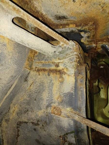

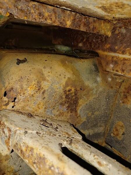

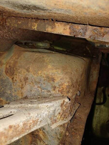

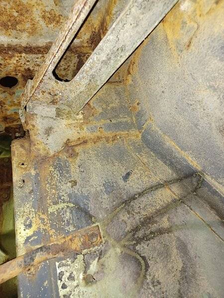

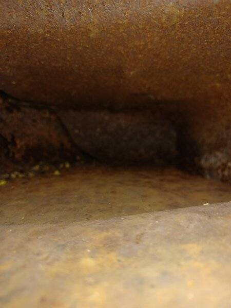

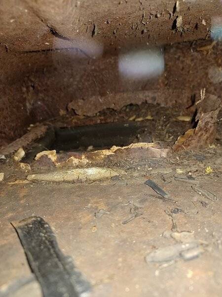

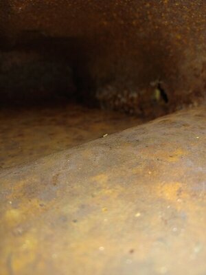

Can the cowl be removed without disturbing the inner fenders? My rust is not too bad but I could find more problems once the cowl is off.
I probably saved it for the most part because I used to take the plastic screens off and was out the debris and rotted leaves at least one a year from about 1988 until the early 2000s.
I answered my own question
Got under the car on my lift and got pics of the cowl under the fenders and got the phone inside the cowl enough to get pics.
Yes I have a large project ahead of me in repairing this area. Seems like I best place to start
20210628_201831.jpg 20210628_201941.jpg 20210628_201956.jpg 20210628_202005.jpg 20210628_202607.jpg 20210628_202723.jpg 20210628_202840.jpg

From what I understand. 71 through 74 b bodies share the same roof skin floor pans and trunk floors. I would assume all 2 door models probably have the same fire wall. If that is true I could look at satellites as well.
I would let others confirm (I am not a 71+ expert), but many mopar cars are very similiar from the firewall forward between 2 and 4 door models. 4 door mopar parts are cheap compared to anything 2 door. Could provide some low-cost repair and patch panels? maybe.
I used a donor piece from a 72 4-door Satty to repair a section of my cowl/upper firewall area. Perfect fit.

The car is not rotted underneath but I have a few trouble spots aside from needing quarters that I already have.
The lower cowl is rotted where the duct connects under the dash.
I'm contemplating drilling the spot welds and removing the upper cowl which is in perfect condition. I not sure If I can do the repair from inside the body once the dash has been removed.
