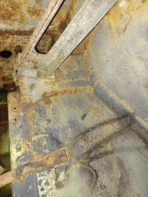

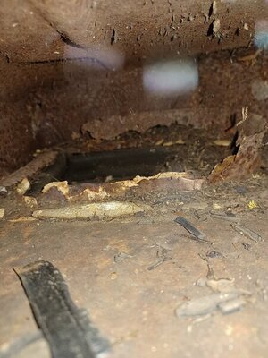

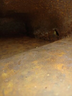

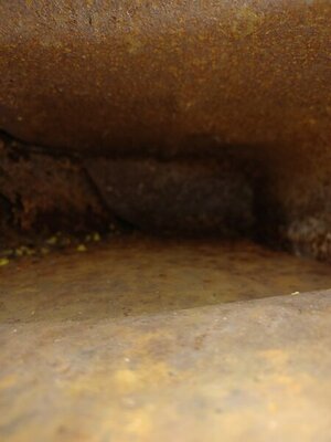

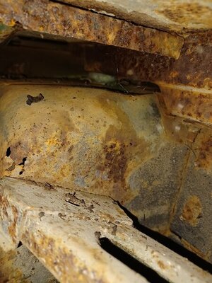

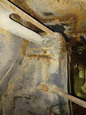

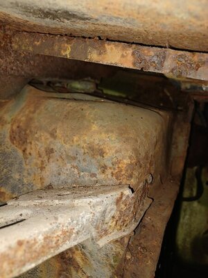

I can't photograph the area in question. I only know about it because I used a camera scope to see underneath the cowl pan. The upper firewall is rotted around the openings for the heater box. Part of the curb or upward bent metal is gone in one spot on each side.
The windshield is out and I'm going to remove the dash and everything inside the firewall.

Thanks for the heads up about the led. Not really a problem but I didn't know to look for it . I'll get pictures when I get the dash and heater box out.

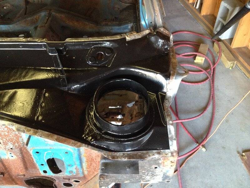

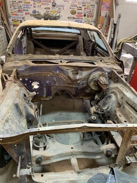

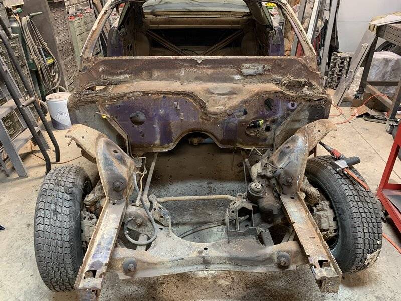

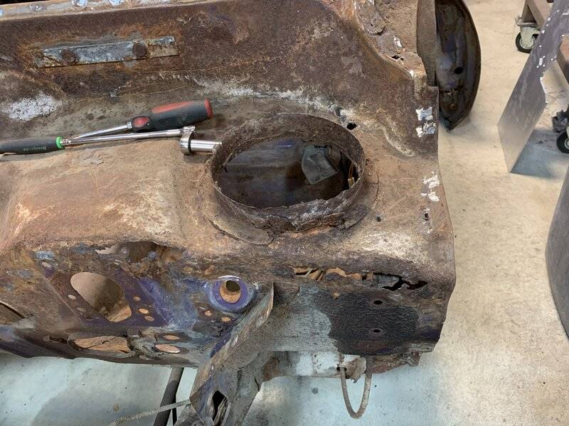

I hope yours isn’t this rusty. Be prepared if you get started... Pics man, We all like pictures around here.:xscuseless:
View attachment 1130257 View attachment 1130258 View attachment 1130259 View attachment 1130260
After seeing your pictures I'm decided that removing the cowl which was my first instinct but was talked out of is the best thing to do.

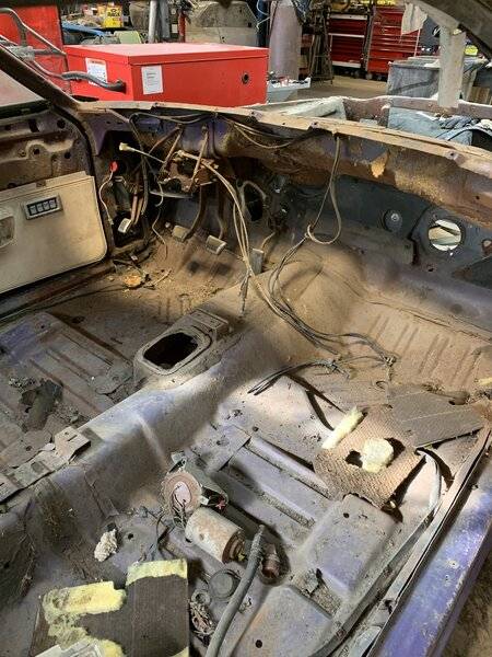

I'm guessing mine looks close but I have to get more apart. The status of your car is the direct I am going. Engine out dash and heater box out. Then I'll start with the cowl and firewall then address the small issues with the roof skin at the windshield. I will get pictures when it's disassembled. Probably in the fall.
Sounds like a solid plan.:thumbsup:

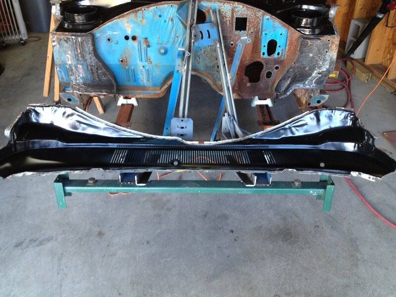

Mine was a nightmare to do. Had to peel back the cowl in spots to gain access to the firewall. Took many pieces like a puzzle. Afterwards i used seam sealer in between the two only leaving the drains open. Then painted it inside. Looks good after the skin of bondo was applied.
Can the cowl be removed without disturbing the inner fenders? My rust is not too bad but I could find more problems once the cowl is off.

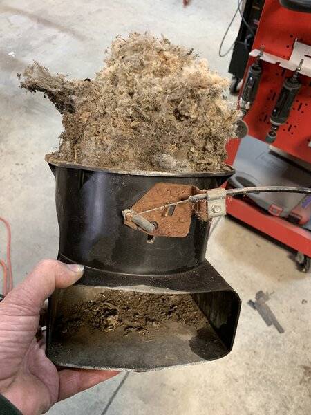

I probably saved it for the most part because I used to take the plastic screens off and was out the debris and rotted leaves at least one a year from about 1988 until the early 2000s.

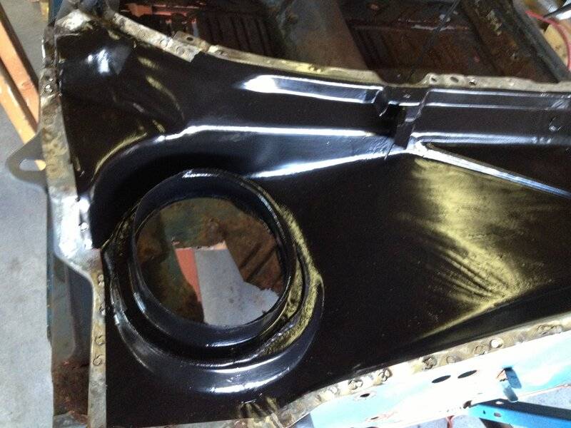

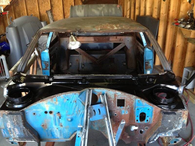

Been there, done that. I used a donor cowl that was better than mine.
It took time but was worth it. I coated the inside with 2K primer sealer and then topcoat with Satin Chassis-black for a hard water repellant coating.

View attachment 1130774 View attachment 1130775 View attachment 1130776 View attachment 1130777
RGAZ
Looks like an older B body. The 72 firewall and cowl is different. Same amount of work though. I wish there were as many new parts available for the gen 3s
