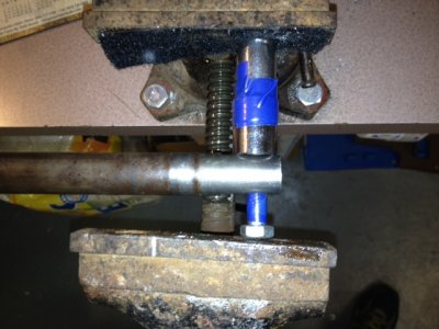

Wow, Thanks for the Idea, had mine out in 10 minutes, most of that was gathering the stuff to do it. lol,,,,, the picture is pushing it the rest of the way out after I got it flush on one side with the shaft. used a bolt with tape for protection.
I also replaced the steering column seal I got from RT specialties #2266738 so My pin needed to come out to slide that on.

The tape was to protect the inside of the shaft not the old pin....."-)
