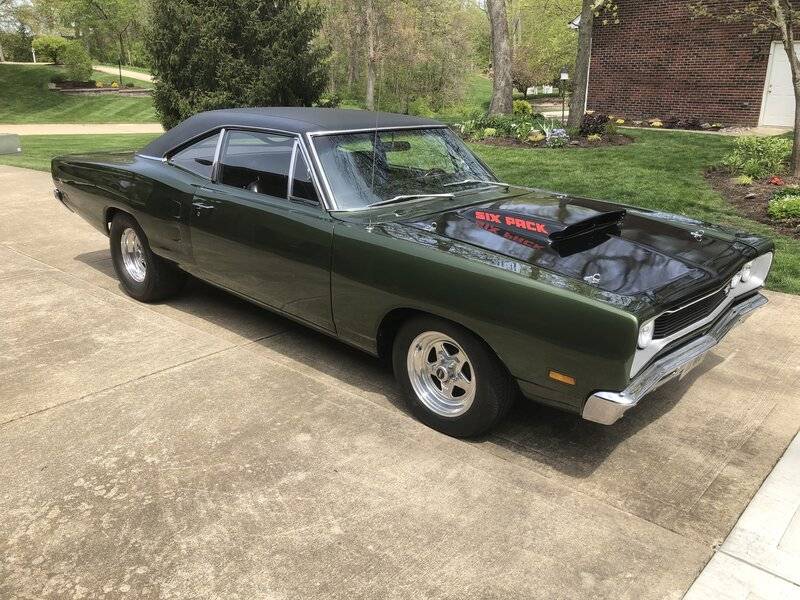

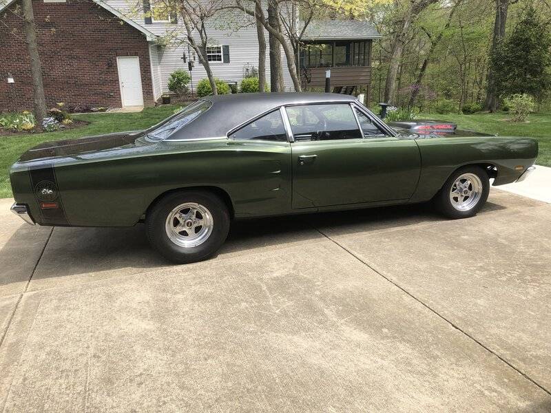

I have a 69 Super Bee with Mickey Thompsons on the back that are 29 inches tall and 12.50 wide. 410 rear. Car is a 4 speed, but bought a TKO 600, that's going in within the next couple weeks. I have 15 in Weld prostars, I think its 10 inch wheel, not sure of backspacing. I like the wide rear tire, but want to improve the ride a bit. Thinking about 295/50/15 on the rear, about a 27 inch tire, but not sure what would be a good match for the front. I guess something about 26 inches tall, but how wide?
Not sure what ride you are trying to improve. A shorter tire will make it ride rougher. A shorter tire may help handling characteristics if the suspension allows it.
Maybe I need to lower the car in the rear
759AAD69-9E9F-4FA4-96C3-E80301808E64.jpeg 2D60DC6C-BE86-4EE9-912B-5E0BB7B863F8.jpeg
i like the Prostars. Also, like the 12.50 inch wide tires!! Just thinking they need to be a bit more under the car. I have raised the front a bit already, but could use a bit more clearance for the 7 qt oil pan. Don't want to keep raising the torsion bars and lose some spring in the front.

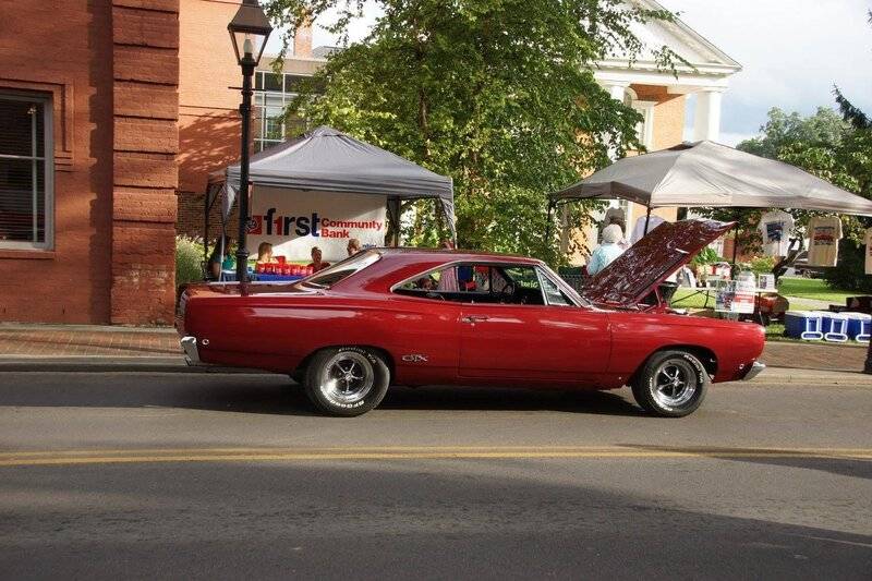

For example, here's mine:
275/60 on a 15x8 Magnum 500 in rear; 225/70 on 15x7 front.
Car rides and drives like a dream, manual steering and all. Stock suspension and shocks, 440 on the nose.
