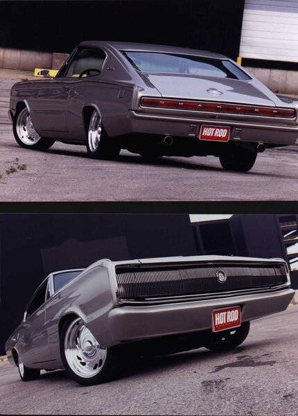

I did this car way back in the late 90's with Steve Strope.
Car was lowered as low as possible,no springs moved or drop spindles.
Tire/Wheels were 17x7 front with 215/45/17 .
Rear were 17x8 with 255/45/17.To me the combo looks small now.
That stance looks great, I was just hoping for a wider rear but I’m used to getting into the 315/345 sizes and I know that isn’t happening
Yeah the 255 were as wide as we wanted to go without rubbing or moving the springs in.
At the time, that was the new stuff for Pro Touring.Hard to believe it was over 20 years ago.
Do you still have that car? Remember when I saw it in the magazine...changed my life. LOL

Gpuller, Sold it way back around 2003. Changed hands several times and last I know it was in Atlanta Georgia.
It was at a show at Year One maybe 2007 or 08.The new owner lifted it and installed Torque Thrusts for more of a 70's look.
Still looked good.
