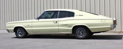

I did a Hotchkis TVS and it dropped my car an 1" or better. The rear had aftermarket shackles that stuck it up even higher when I purchased it.
I have 18" Cragar SS rims to put on the car with new disck brakes but that work is in process and not complete.
The pictures are before / after and before / after.

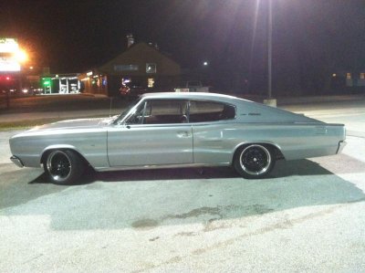

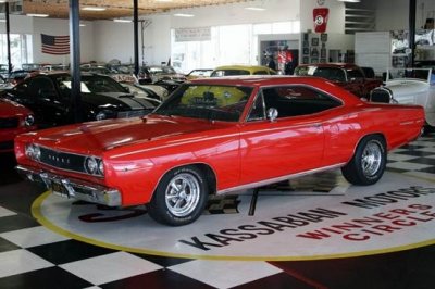

More or less did the same as Jim Bob, Hotchkis (road race)rear leaf, torsion bars and adjusted the front end height with the torsion bars. Wanting additional camber I went with FirmFeel uca's and added boxing to the lower control arms. Also went with 18" rims and modern tire technology. It is now very fun to drive. Can't forget total front end rebuild with PST poly kit, too.
Before
After
I may go lower in the back to flaten the car out but I need the 18's on first. I would not go with the 2" drop spindles if you are going to up the torsion bar size to the 1" range or higher. There are a few people on this site that have gone that route only to go back to stock height spindles when doing the rest of the upgrades. If you take the time to plan out your build you will be dollars ahead in the end.

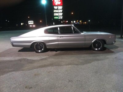

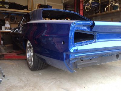

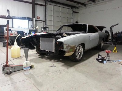

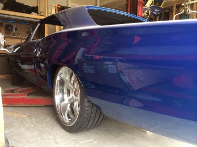

The member on here with username Red Stripe has a Charger that's lowered about how much you're talking about and looks killer, 17" front/18" rear staggered wheels like the Mr.Angry '68 Charger and mine too. I haven't gotten around to the rear lowering yet but for now I'm just lowered with the tbars and going to machine 1-1/2" lowering blocks for the rear (still need to get tubular uca's too). Worked good for Mr.Angry so should work alright for me too haha

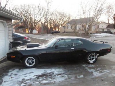

My car:

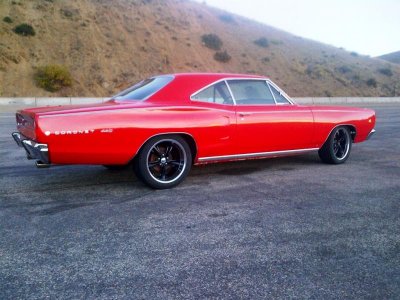

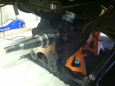

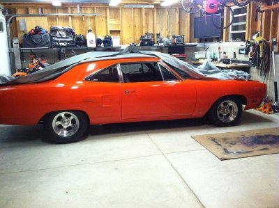

Mine is Firm Feel with Magnum Force 2" dropped spindles and 1.03" torsion bars. I'm also at 4 degrees of caster and the car handles like a slot car! I like the look on 15's but am looking for a set of 18's also for road performance - you just can't get tires for 15's any more unless you're a drag racer, or a Prius...
The cardboard on the floor is because my wife's (new) Volvo leaks. Roadrunner is fine though!
More details in my threads if you want them. Looking for a better pic, but for now:
View attachment 173523View attachment 173524
that has a nice stance, 18,s may be too much. might look at 17,s as option.

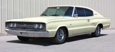

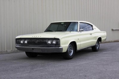

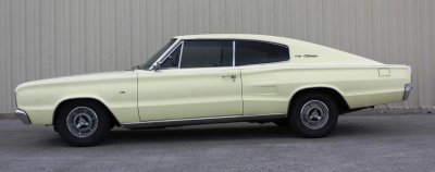

IMG_2679.jpgIMG_2923.jpgIMG_2921.jpgI went with the quick and easy way to lower my '66 Charger. I loosened the torsion keys on the front and used 2" blocks in the rear. Of course, that went too far in the rear, so I put some air shocks back there so I could adjust as needed depending on luggage and passengers.
Okay...it aint a Charger or Road Runner, but it IS a B body and it IS lowered. Iso-junk is gone, 3 leaves per side gone (****, it HAD 6), ripped some 2" blocks down to 1.25" to get it too low, and use air shocks to get the ride height where I want it...similar to what BDL did. The anti-air shock crowd will no doubt weigh in here, but the shocks only raise the rear 1 to 2 inches before the leaf springs take over, and my junk aint rusty. AirRide Shockwaves operate offa the same principle, they're just more expensive. Mine are Gabriels. The front came down via the T-bars, but if you go too far the camber gets all wonky. Not so much a problem with the older cars due to the UCA eccentrics, but the later cars (like mine) don't have that. Dropped spindles are probably the better way to go if'n they're available. BTW, in the picture my air shocks are all the way down. Ride height in the rear is a bit higher than that. The second arty-farty picture is closer to what actual ride-height is...
