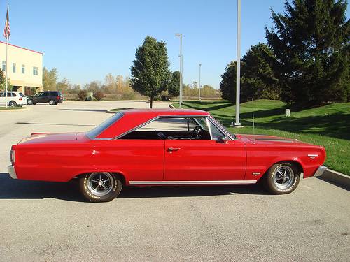

How do you lower a b-body... for instance my 67 belvedere II, its definatly set to have the gasser look, I do want to drop it to have a more subtle look.
right now im at this:
as you can see the ft fender is about 3 inches above the top of the tire.
What I want:
either just at or just past the the top of the tire tread with the fender.
You have to be careful not to take all the preload out, but you do it by backing off the torsion bar adjuster bolts which are located in the underside "middle" of the LCA. It's a 3/4" headed bolt. Just back them off, bounce the nose, and check your height. You'll probably have to do it several times to get it "right"
