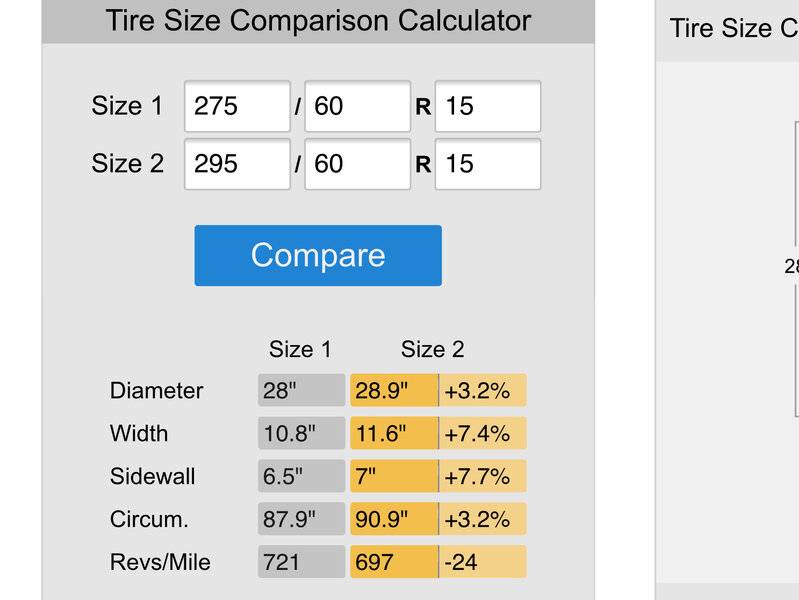

Are you trying to go fast with sticky tires? Because that 15x10 steeel wheel will be Very heavy. I have 15x8’s that are 30 lbs each. Boat anchors if a low ET is desired.
If it really is 29.6 tall then you may have clearance problems at the front of the wheel well. My size chart said 28.9 tall.
I compared it to a 275/60-15 which is used a lot and fits fine on a 7“ or 8” wheel
