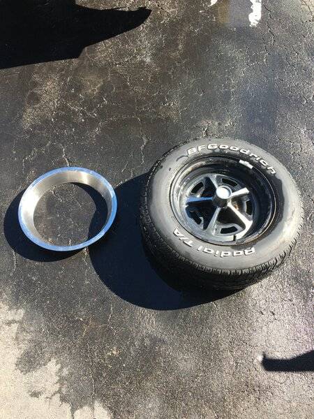

I just picked up a set of used 14 in mag 500’s with center caps and trim rings with radial tas from $200. They’re 14x6 with 5x4.5 bolt pattern 3699331 mopar part number all they need is some paint. I currently keystone classics they look good but a pain in the *** to put on because they have a universal bolt pattern . Will the mags fits right on my 71 rr with ease?
Your new wheels have trim rings? Then they are called road wheels. Magnum 500’s are the chrome rim version.
Yes these are a direct bolt on wheel you will need acorn lug nuts for these wheels. No uni lug hassles like on the keystones!
