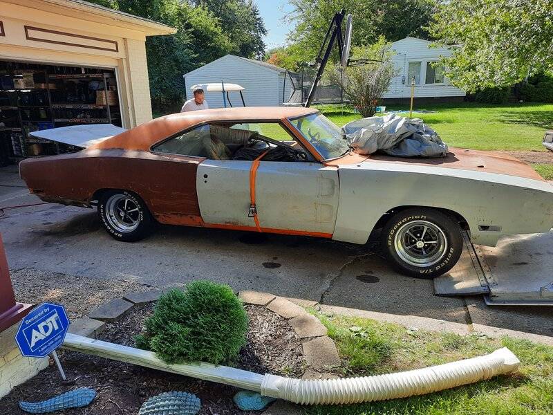

Thanks everyone for all of your time and input. This is a great community, and I really appreciate it!
Actually, I just ordered the 11.75" rotors from Dr Diff a couple of days ago. I am planning on going to the 15" rims. I'd like to put 15x9 rear, 15x8 front. Not 100% the 15x8 will work up front...I really don't want them to rub.I can't speak for aftermarket parts, but I had a 73 challenger with the 10.95 unicast rotors that had 14 " magnums from the factory. If you have the 11 3/4" rotors then you will need 15" wheels at least. Dr. Diff could probably help you out with that.
