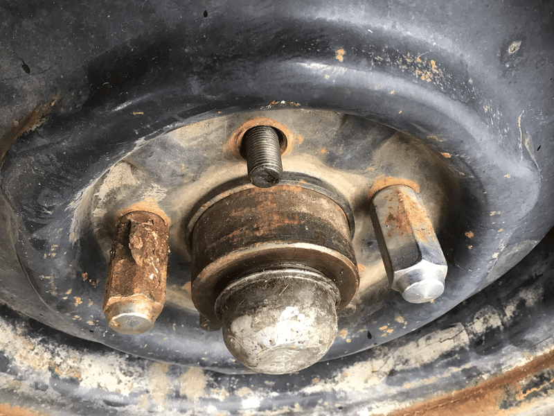

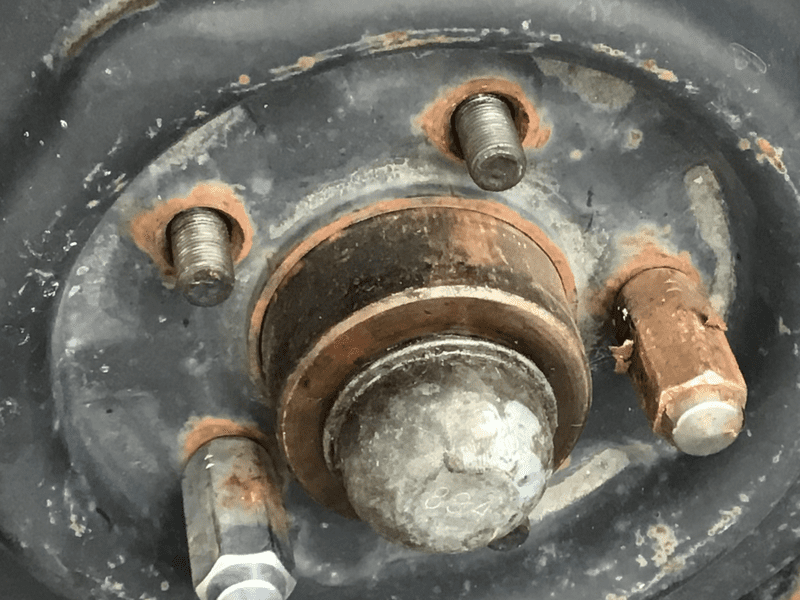

Hey guys, I need some help figuring out why my '66 Coronet Deluxe 2 door sedan wheel hubs appear to be too big for Magnum 500's and Chrysler Road Wheels.
I measured mine at 2 3/4" or 71mm. I did a front disc conversion from Doctor Diff, and the hubs are the same size as the stock rear drums.

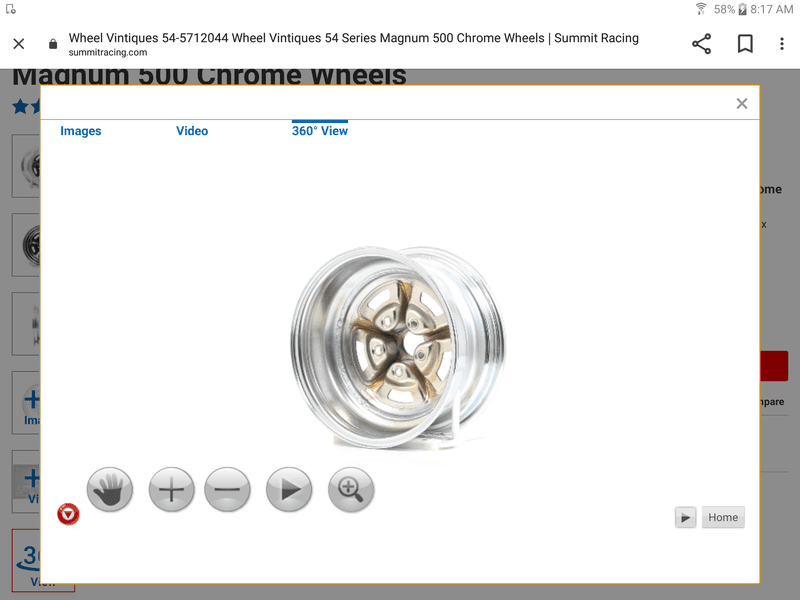

Coker Chrysler Road Wheels center bore is listed on the Summit website at 2 1/8", Wheel Vintiques Magnum 500 Road Wheels are 2 1/4".
This has been making me crazy for the last 2 days-measuring/re-measuring, searching posts threads and reviews, calling different companies. I see pictures of 66' and 67' coronets with these wheels all the time, but I can't find anything addressing my problem.
What am I missing???

Look at this hub. A magnum 500 wheel won’t fit over this hub. It’s a mid 70’s disc brake. The Huns they fit over tape down to nearly the same size and the dust cap.

I don't understand it either! I spoke with wheel vintiques yesterday, and they told me the center bore measures 2.25". My hubs are 2.81. That doesn't fit.
The center hole they are talking about is the center cap hole. The wheels themselves are not hubcentric, and have a large area where it fits over the hub.
I never looked at the backside of the rims. I assumed the center bore went all the way to the back. So frustrating, yet so relieved now. I knew I was missing something!
