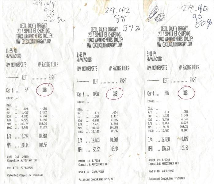

A major milestone and great day at Cecil County Dragway’s Test and Tune session on Saturday 5/26. The car’s first pass ever resulted in a 10.88 @ 104.56 on 5 year old 29.5x9.0 M/Ts and running out of fuel after the 1/8. Need to work out a few kinks (as expected) goal is to run 10.00 index.

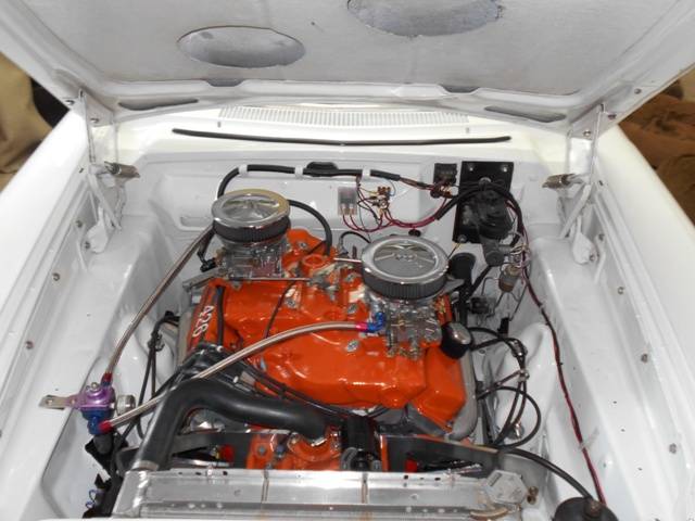

Nice keep at it. Tell us more about the engine. Heads cam compression etc.

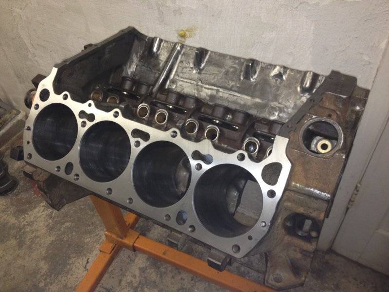

505 Cubic Inches
12.3:1 Compression Ratio
Partially filled block/billet steel main caps/studs/girdle
1050 Dominator (currently on gas)
Edelbrock Victor 2893
Indy EZ-1 Heads
Solid Roller 272/276 @ .050 .413 lobe lift 108 LSA
Bushed lifter bores
Harland Sharp 1.6 ratio Roller Rockers
Jesel belt drive
Milodon dual line oil system with swinging pickup
max wedge or standard ports,, never mind

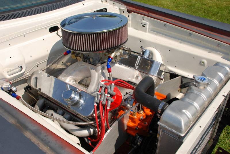

I run about the same combo, but 499ci, same cam w/1.5 rockers and same heads but with a crossram intake. You should get to 10.00s no problem with that intake and carb.
Keep us posted.
Keep us posted.
Guy- To tell you the truth, the crossram is what started this whole thing! The LOOK. The SOUND. I've got one on the shelf with a set of modified 750 Eddies, linkage, etc. ready to go... maybe after I break into the 9s what's your best ET with the crossram?
Best 10.19 @ 130
Thru mufflers and air cleaners. I haven't tried all the tricks to run quickest, usually testing to see what it takes to hit the 10.50 index

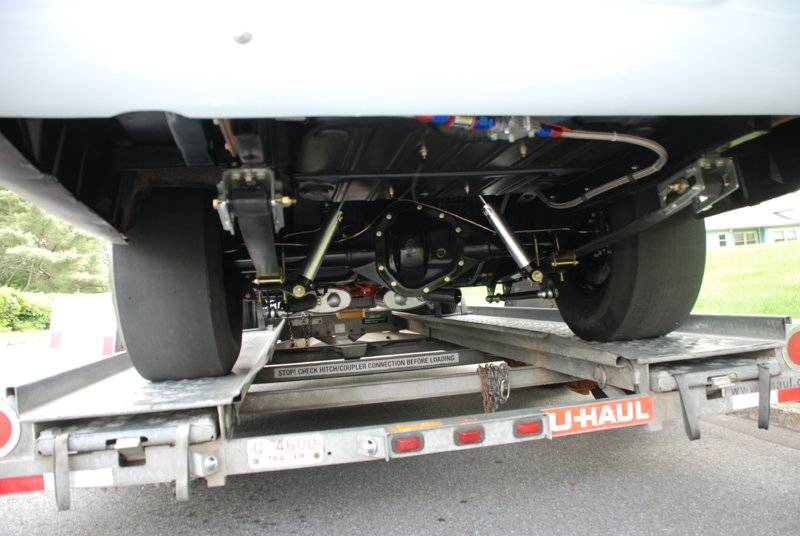

Fresh rubber,little more preload and stiffen those shocks up and low 10's for sure!! Who's shock is that??
