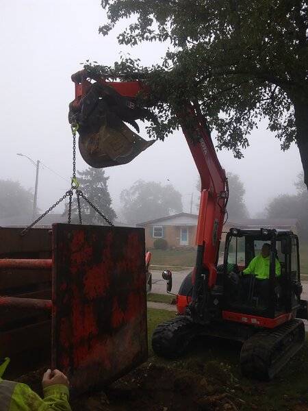

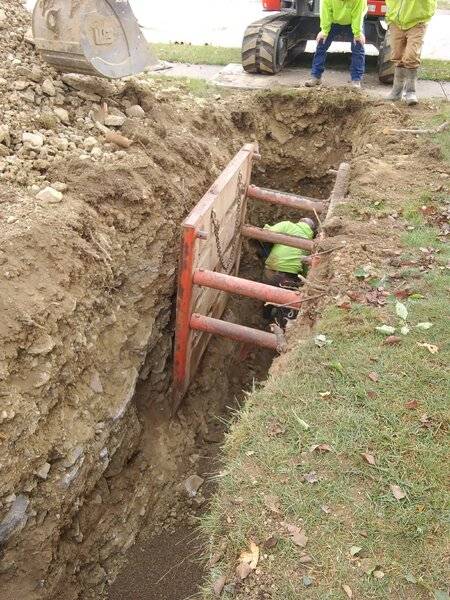

pops, where's your trench box? I know, didn't need one! until you do!

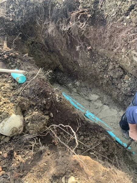

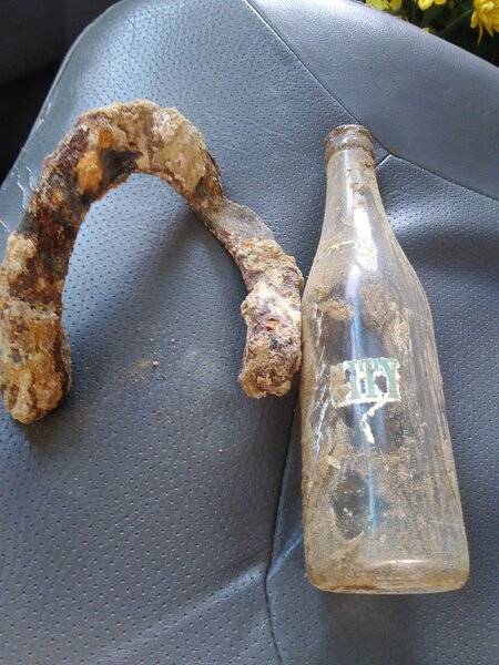

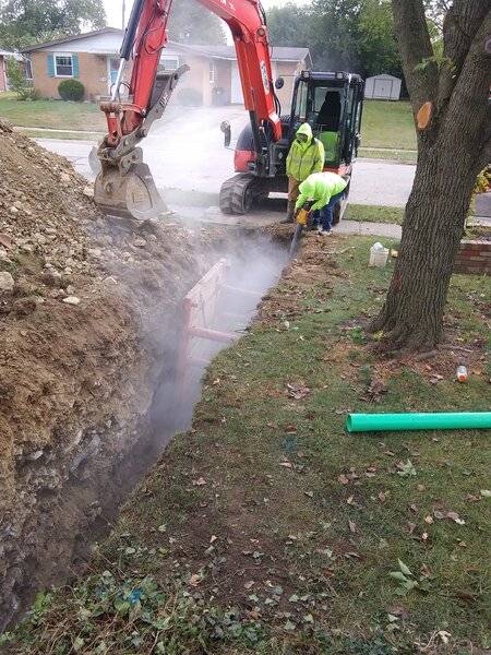

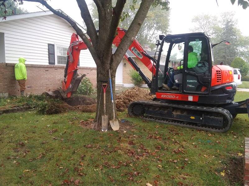

Today was replacement day. I was amazed at the amount of stone. They had to use a quickie saw to cut through it, by where they tied in. They unearthed a real horse shoe, and a pop bottle, that had the word, city, on it. Great crew, did a great job.

Anyone ever heard of, city, cola ? I think thats whats printed on the bottle.
