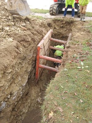

first thing I would do is contact local township administration and locate lateral depending where it's located will be the deciding factor of who has the right equipment to perform the work.horizontal boring would only be an advantage if it was a very long run in an already landscaped yard. still need to excavate holes at building and to add clean outs every 100' depending on local codes and the lateral connection so there is still some mess to clean up!! how deep is the lateral,a trench box may be required unless you slope the excavation back and depending on location/soil conditions, maybe not an option! pipe should be bedded/covered in "A gravel".
locating the lateral can be very tricky without damaging it and I've seen some as deep as 12'. I've inspected hundreds of water/sewer new installs and they were all different unless your working in a subdivision and a must to make diagrams of install.
dishsoap to put those bell ends together,they can be a struggle!
HIRE a PRO!

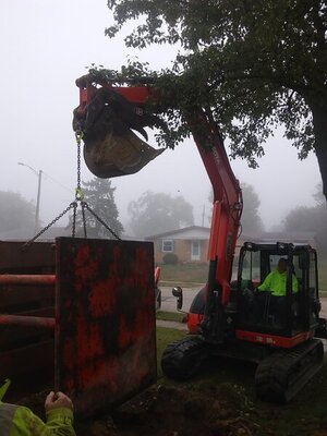

pops, where's your trench box? I know, didn't need one! until you do!

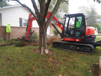

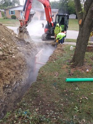

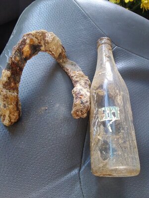

Today was replacement day. I was amazed at the amount of stone. They had to use a quickie saw to cut through it, by where they tied in. They unearthed a real horse shoe, and a pop bottle, that had the word, city, on it. Great crew, did a great job.

Anyone ever heard of, city, cola ? I think thats whats printed on the bottle.
