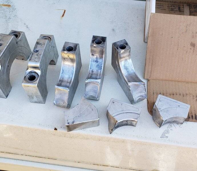

no time to skimp now, the expense overall in the big picture is really not that much and good insurance, i just did all that except i went steel main caps with studs, and waiting to install 1/4" girdle. scat crank and rods/2000 bolts, no place to skimp either on the rod bolts. had it all professionally assembled at s&s machine, hayward. money well spent. your heads and cam will determine how much xtra "strenght" u will need down below.View attachment 994571
What caps are Those?? what power levels you running and what girdle? Thanks
If nothing else, my Aluminum caps probably saved my block when my crank cracked.
