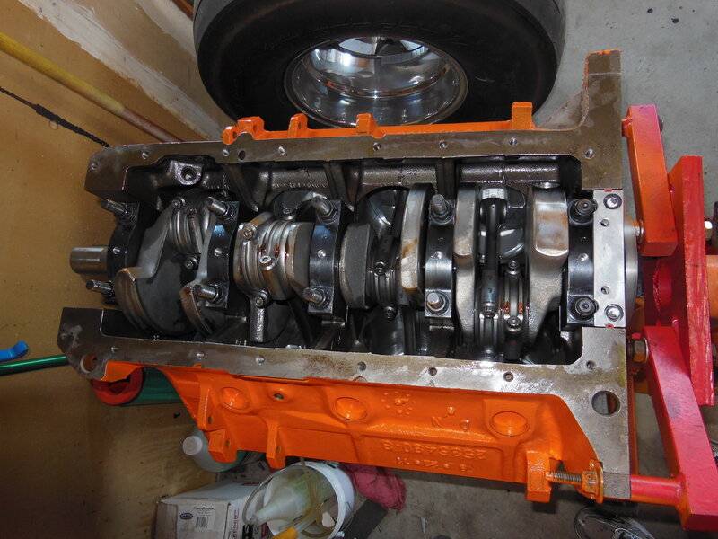

no time to skimp now, the expense overall in the big picture is really not that much and good insurance, i just did all that except i went steel main caps with studs, and waiting to install 1/4" girdle. scat crank and rods/2000 bolts, no place to skimp either on the rod bolts. had it all professionally assembled at s&s machine, hayward. money well spent. your heads and cam will determine how much xtra "strenght" u will need down below.
no time to skimp now, the expense overall in the big picture is really not that much and good insurance, i just did all that except i went steel main caps with studs, and waiting to install 1/4" girdle. scat crank and rods/2000 bolts, no place to skimp either on the rod bolts. had it all professionally assembled at s&s machine, hayward. money well spent. your heads and cam will determine how much xtra "strenght" u will need down below.View attachment 994571

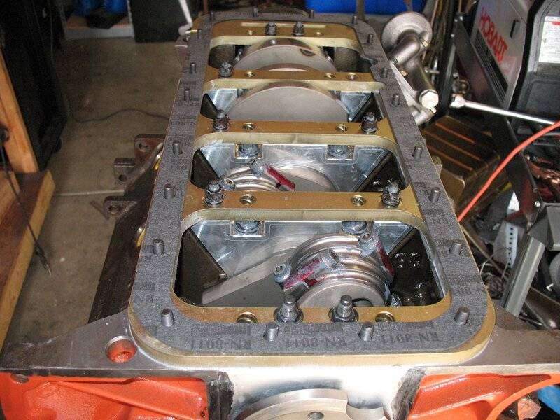

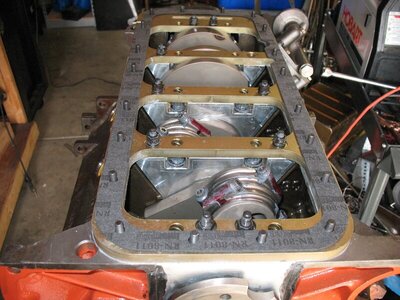

Found a picture of the BCR aluminum caps and girdle on the engine.
