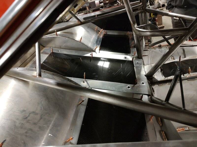

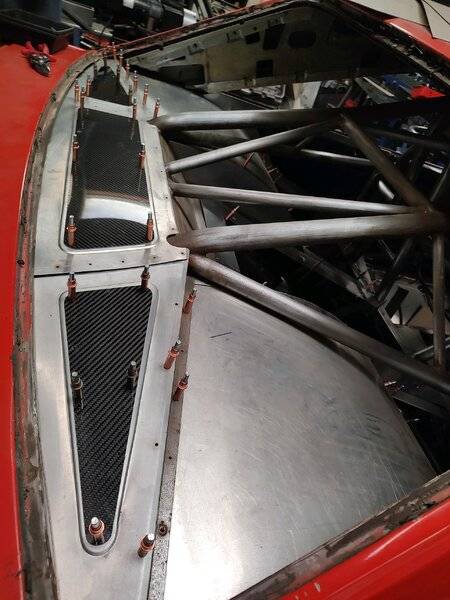

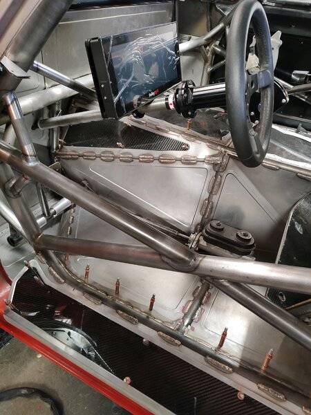

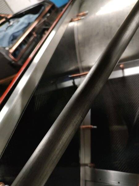

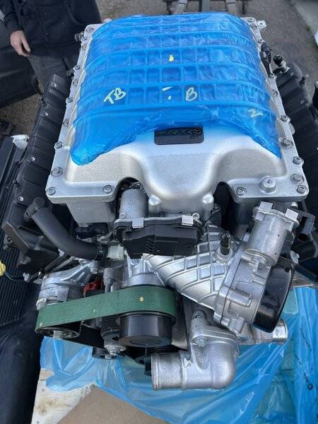

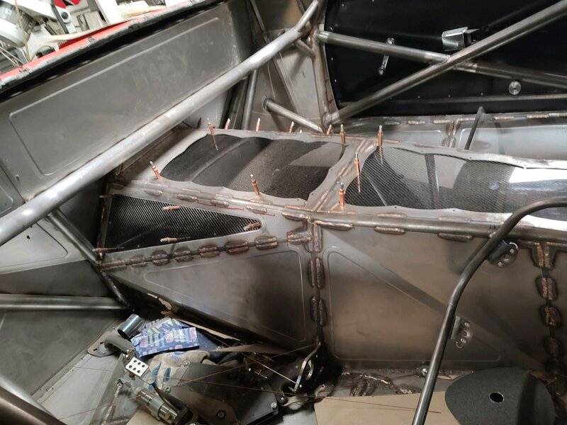

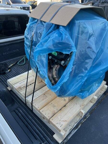

New motor finally arrived, inside close to being finished. Now everything has to be taken out and wet sanded prior powder coat. The motor is a 2022 Demon / Redeye factory crate motor. Bigger injectors, pulleys, new fuel rails and some other items are still on the way or back ordered. Pictures don’t do justice how nice the interior tin work and carbon inserts look.
How much hp/tq is that 'Demon / HellCat' crate motor rated at ?
or has it been dyno'd ?
I assume you know all of it already anyway...
But;
Demon engines 840hp/770tq on 100 oct. fuel
with the right keyfob/computer/Power Control Modules
base was (808hp/717tq on 91 oct.)
& had a different camshaft & bigger blower (2.4ltr vs 2.2ltr IIRC ?)
different pulleys (maybe injectors also)
different power control modules,
activated by key fobs/supplied crate parts too etc.
10.40 @ 132 average
professional driver did get it down to 9.49 @ 140 (or was it 9.69)
ideal conditions on a prepped track
the RedEyes 797hp are like the reg. org. HellCat 707hp engines, just more hp
I assume in a pulley (maybe injector) change (crates)
RedEye cars were made road course ready, wide bodies
but allegedly would do 10.80s (IIRC)
Demon was dragstrip ready, wheels up from the factory
315 drag radials
View attachment 1254740 View attachment 1254741 View attachment 1254742 View attachment 1254743 View attachment 1254744 View attachment 1254745
Again your fabricator, does extremely nice/clean work :thumbsup:
I'm a lil jealous :bananadance:

Demon motor and Redeye same engine. Difference is Redeye doesn’t have file tune from factory to unlock the 840hp tune. I am running Holley Dominator ECU and E85 so no factory computer. Dodge dynos all Redeye crate motors before they send them out. I will be running 10% overdrive sfi dampner required for the track and a smaller upper pulley. Should make 1,000hp.
And bigger injectors, see what it will run before motor comes apart.
