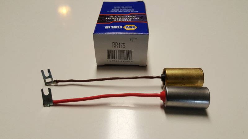

Have a picture and how many MFD? The new ones are all like that.

What do you need? The one I posted I'm useing on my Mallory dual point with the Mallory coil. I have just over a hundred miles on it so far. It's probably the only one out there with that lenth lead.
If it wasn't up to specs, it probably wouldn't have lasted this long. There's not that much difference between the discharge specs for most V8 condensers.
What do you need?
Ecklin condensers, I was looking for the MFD info, on 'em. Nadda.
The difference between mine, mechanical advance, and your's w/ vacuum advance, is the only reason I see, why you need a longer lead. Condensers mount slightly different locations. But, I picked up a ECH RR174, and will give it a shot, with it's 2 3/4" lead.
