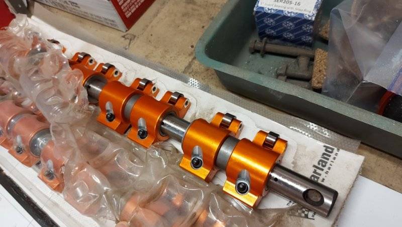

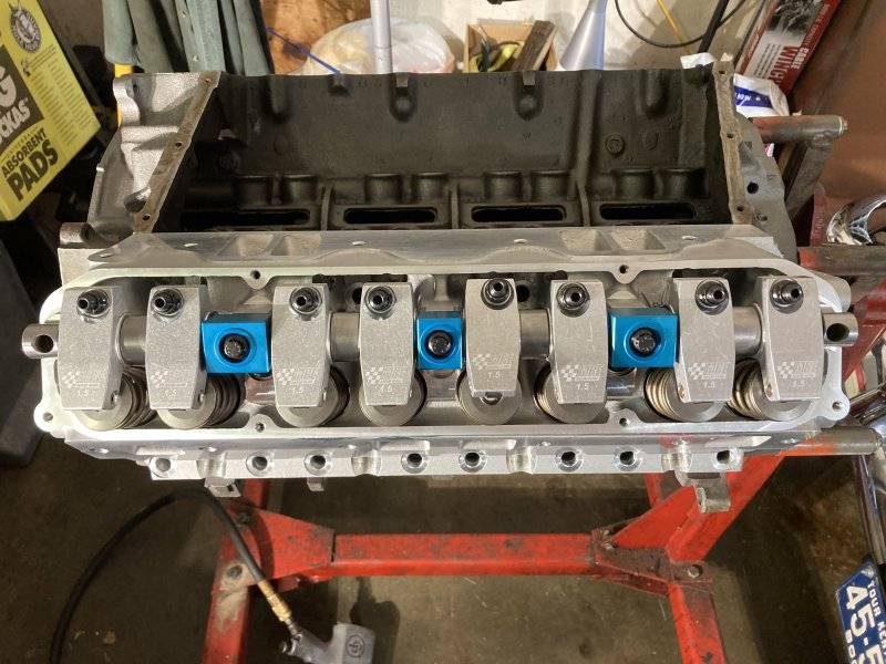

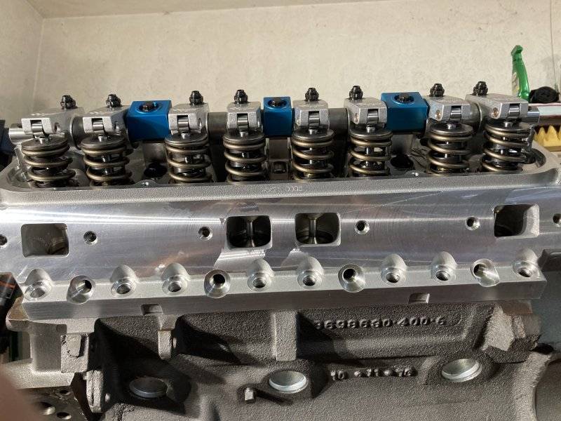

Received mine this week, no instructions? The product, looks well built. Installing on 400, new stealth heads. Will admit, it’s been since the mid eighties, that I have messed with B/RB engines. Thought it would be self explanatory. Installed the 8 shim washers on each side of mounting pads/blocks, one each at end next to mtg. pads. Then the 4 spacers between rockers. Look super close in location, rockers moved as should. Started tightening mounting bolts, from center out. Noticed end bolts were very snug, while tightening them. Stopped, pulled out, examined, proceeded again, really tight, stopped, rockers are jammed tight, no movement. Frustrated after things going pretty good on a hot/humid/raining day.
Today going to check part number ordered, fill confident they are correct. My question….do you not use all spacer shims? 16 total for both heads & 8 spacers. Here is pics
Mancini sells a kit with thin shims to customize the clearance to your liking. No two heads are the same so you need to adjust with different shims.

Just figured this out a few minutes ago. Shims that came with that I mocked up was to tight, pushing the end mtg.brkts outward, causing the bind. I took out the spacer washers at the end mtg.brkts., helped but center rockers to tight. Without any kind of paperwork or directions, besides the invoice, may have helped & further customers. SC440 I appreciate your input, it’s greatly appreciated

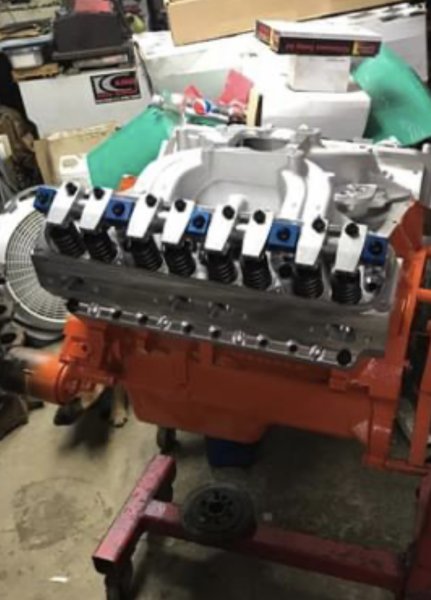

I’ve seen these rockers outlast top dollar HS Rockers and they were perfect for my TF 240 Heads. Here’s what mine look like 6 years ago.
