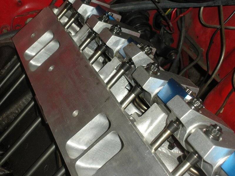

I would love to see some pictures of someone's valve tip swipe pattern with those special Harland rockers to see just how much of a difference they make. Of course the cam lift has an effect on it too...
All aftermarket rockers can stand to have the geometry fixed on a big-block Mopar. That's why I'm anxious to see how well these 'made for Edelbrock and TF' rockers compare.
Unless I've missed it nobody's put up a picture either here or on FABO as of yet.
