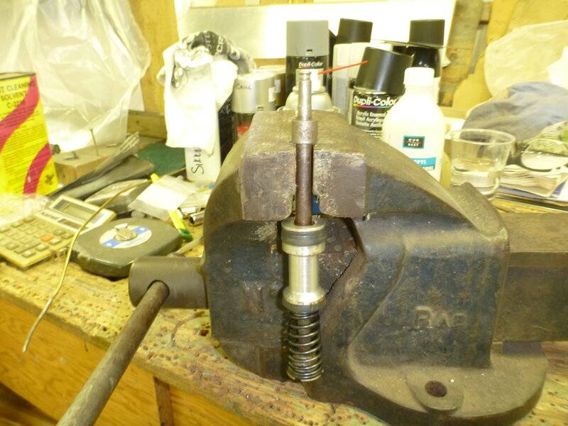

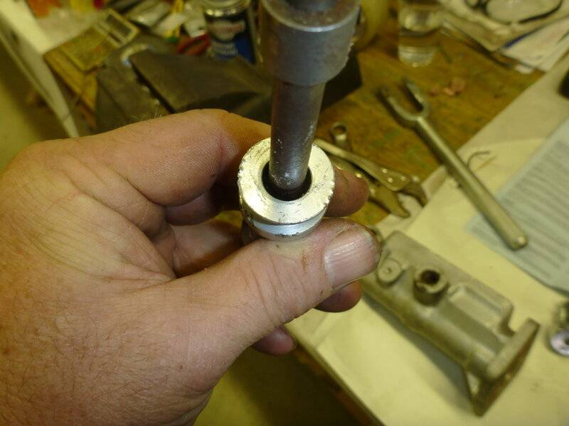

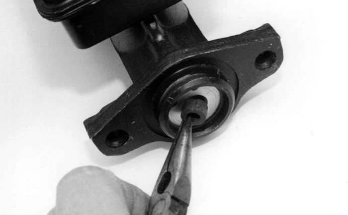

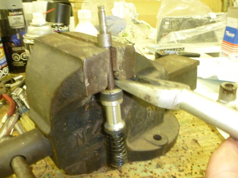

Every brake master cylinder post I've seen on this forum has always stated "don't forget it and don't use a piece of rubber hose in it's place". No reason not to believe that mine coming apart wasn't OE...

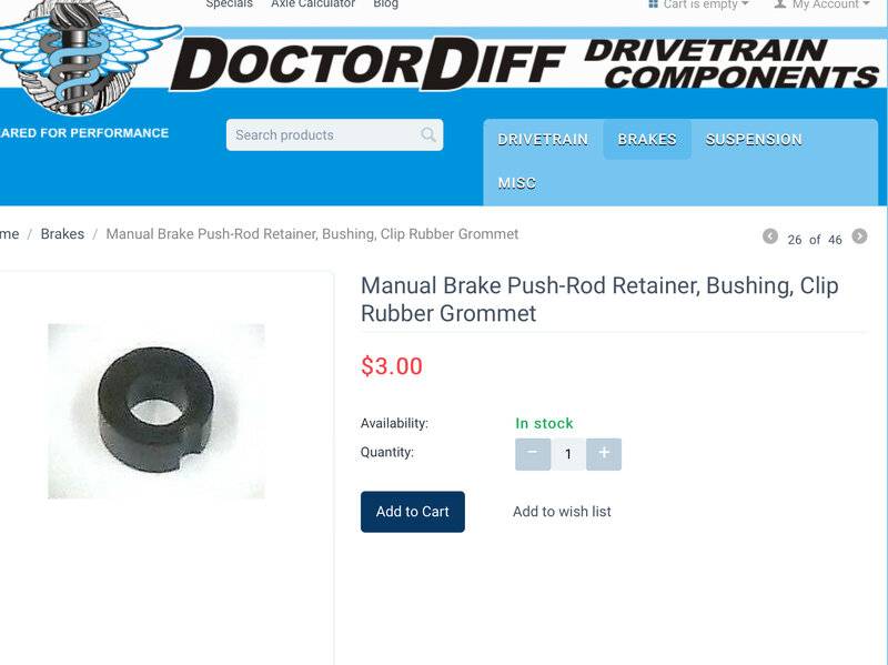

Look what DR Diff calls it.
https://www.doctordiff.com/manual-brake-push-rod-retainer-bushing-clip-rubber-grommet.html

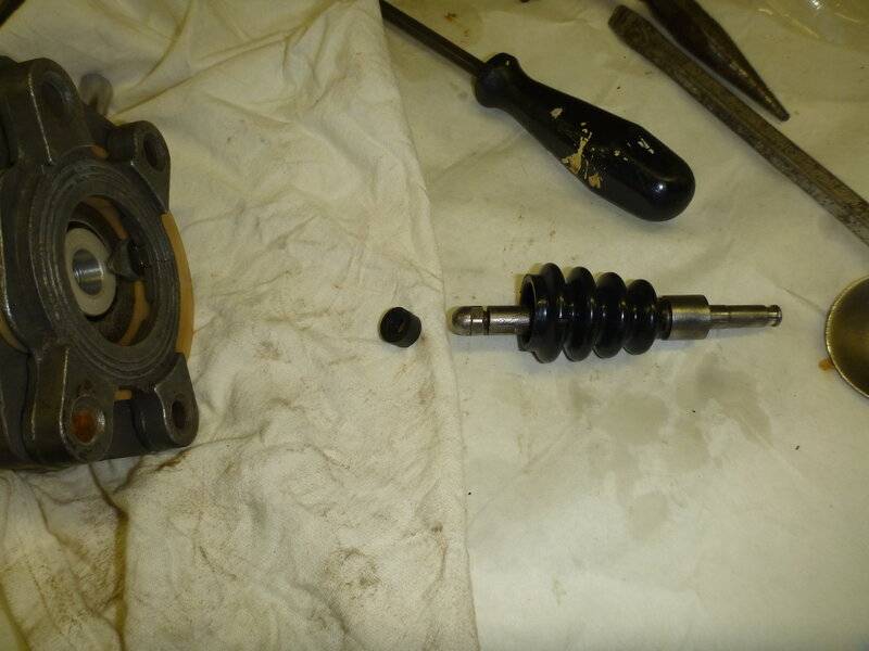

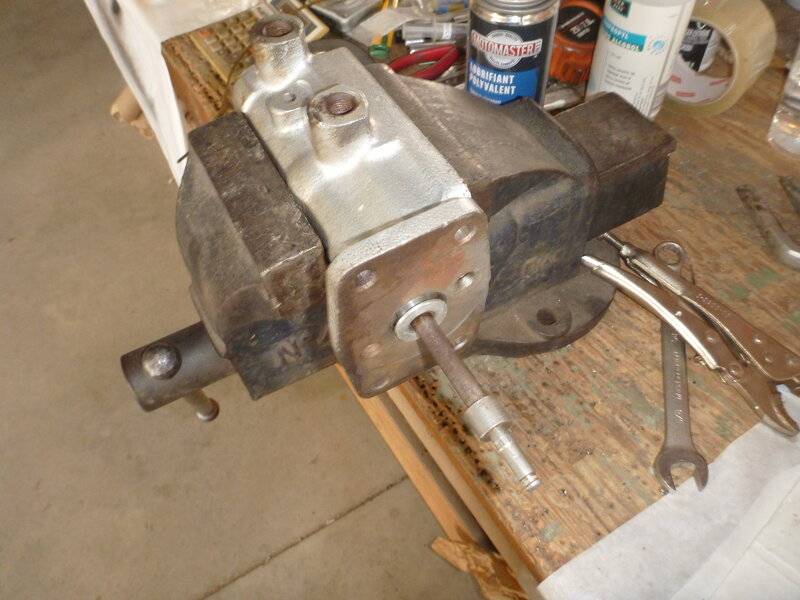

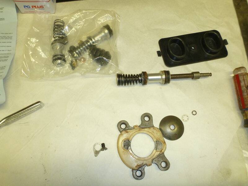

That's good.. LOL...like I said above I have no recollection of the master ever being changed that it didn't come off the line that way... and with a bit of picture surfing I know what I did going back together...

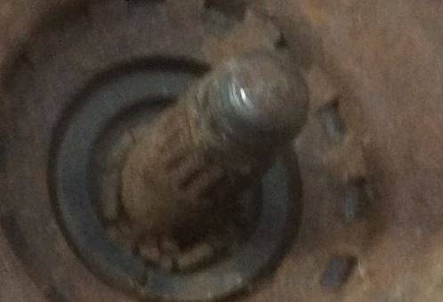

That accordion boot doesn’t go in a power brake car either. And there is no machined spot on the pushrod for the retainer to slide over, just a small space for the adjustable end to travel.
Yeah, that's what I was thinking reading Dr. Diff's ad for the "Manual" brake push rod retainer! I'd
hate to put one in and then pry on the Master and screw up my booster! Their big money. Thanks
for the input! I'm gonna go put my Master on without one and be done with it.
