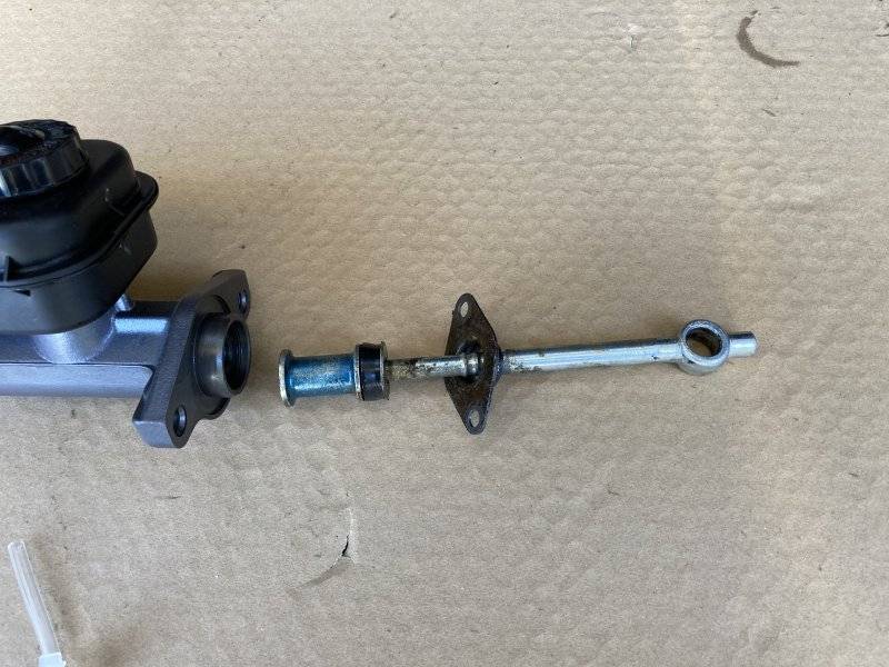

I’m replacing the single MC for a dual unit.
Do I reuse the rod from the pedal to the old single MC?
I ask because the rod will not slide into the back of the new MC. Plus there are no bolts holes in the new adaptor plate to hold the bracket from the old MC.
1st pic is of rear of old MC
2nd is pic of new MC and brake rod.
3rd is the rod itself
Suggestions on using the new MC or do I do back to the old single MC.
Dr Diff sells a new rod but it’s for 66 and up. Mines a 1965 Coronet.
Suggestions?
If you buy the aluminum MC kit from Dr. Diff, it has the groove for the rubber retainer and he includes a new one with the MC purchase as well as the adapter to bolt to firewall. You can then just use the stock push rod.
Like @R413 said, you need to remove the piston from the rod, same thing happened when I removed my old MC. A few hammer taps and it will come off.

If OP ends up buying an adjustable pushrod because of the 2 bolt to 4 adapter, stop switch won't work. The nub at end of pushrod works the switch. Adjustable doesn't have that nub.
1. Mike is right. Most people would just get a 67 m/c and go.
2. If you want to use that one, you can drill 2 holes and mount the 2 bolt cyl directly.

The rod came apart with a little hammering :).
All apart and ready to install. Cass from Dr Diff provided links for the MC and MC lines. All came apart except the pass side line from the distribution block. But new line ordered and ready for brakes! Thanks for the advice.
