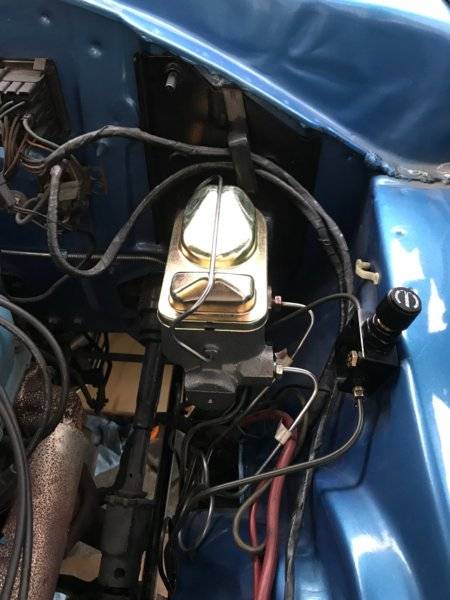

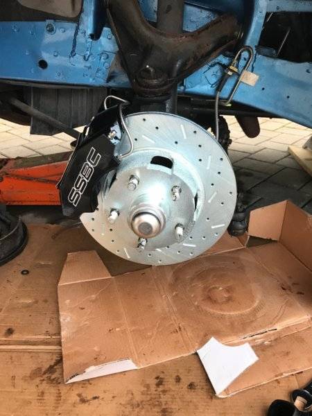

I converted my 70 Satellite front drums to disc with the SSBC kit and a 15/16" manual master. Car stops great. I liked the SSBC kit cause it uses the drum spindles and I didn't have to touch the front end at all which was in great shape. It was a straight bolt on. I also totally rebuilt the rear drums- drums, shoes, spring kit and wheel cylinders. Don't forget you will need a proportioning valve.

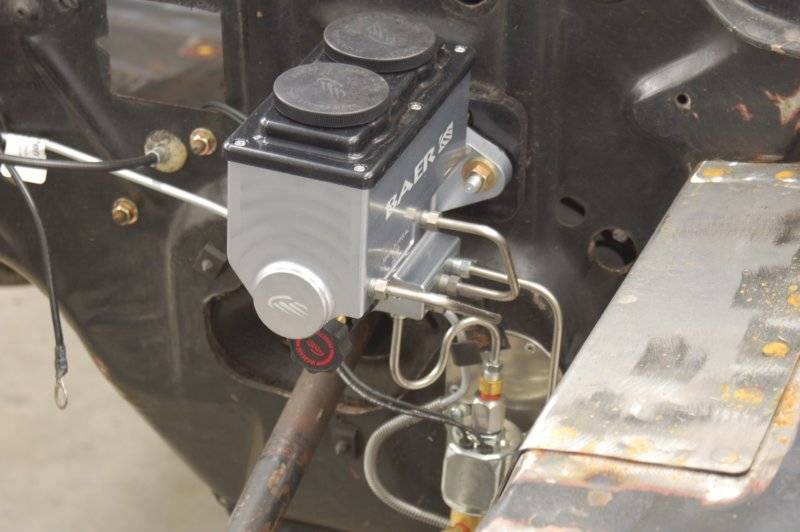

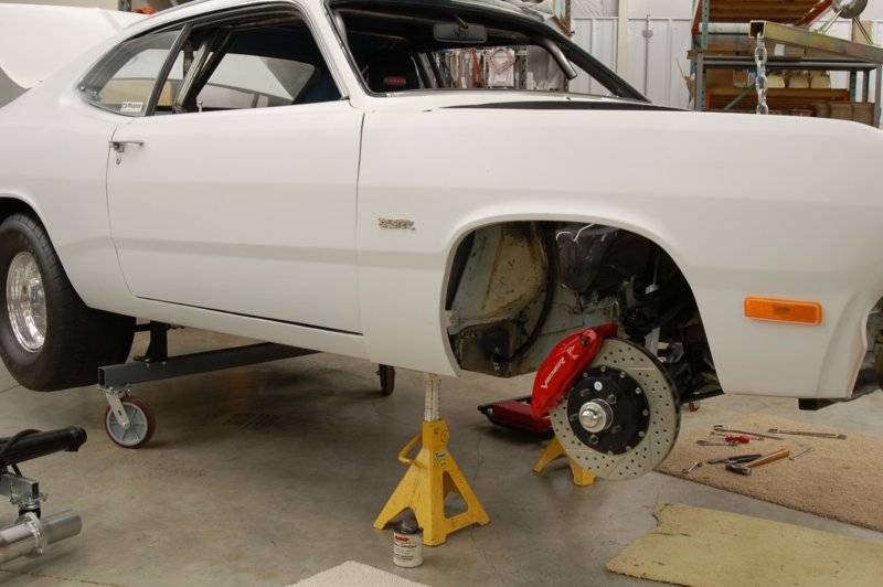

I don't think I'll ever put power brakes on any of my cars. Manual discs work just fine for me. My Duster is going together with Viper brakes up front and Ford Motorsport discs out back. I'm using the 15/16 billet master cylinder from Baer.
