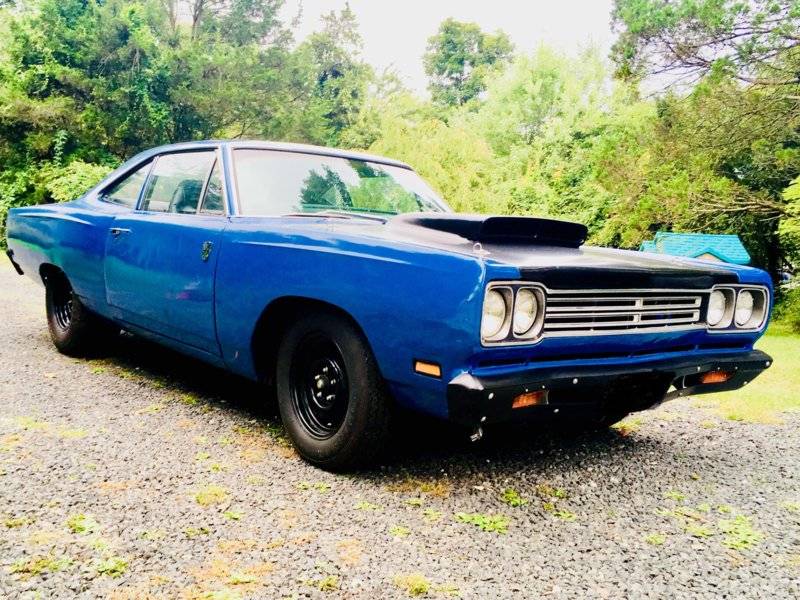

They’re awesome! I hate power brakes and my car came with manual brakes. Due to some power upgrades I decided to bump up the drums to disks. All Mopar parts.

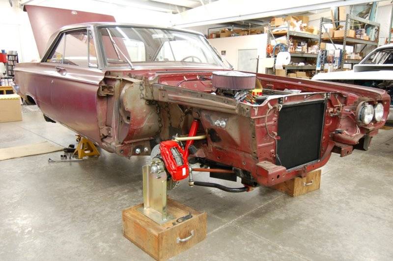

Manual disc brakes work as long as you have big enough rotors. The factory 11.75 rotors would be the minimum size for manual disc brakes with a big heavy car like a '70 B body. I have manual disc brakes on my '65 Coronet and it stops really well but I upgraded to 13 inch rotors.
Your car should stop okay if you have 11.75 rotors up front and big drums in the back. If you have the 11 inch drums or can upgrade to them then that will help.
