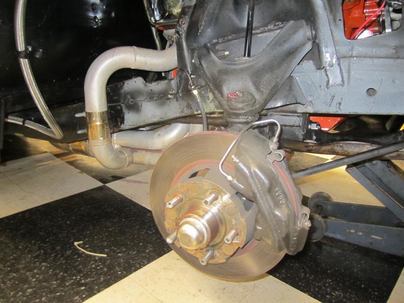

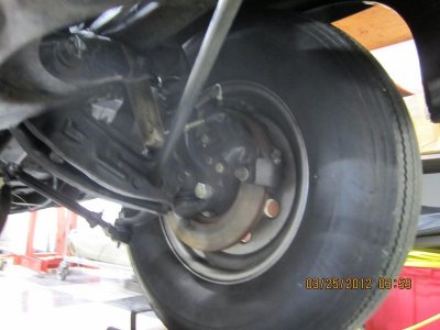

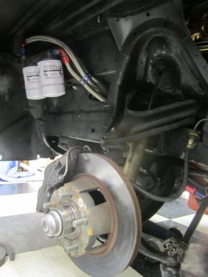

I also went with the SSBC kit.My 3800+ lbs have no problem stopping from 130+ mph.
