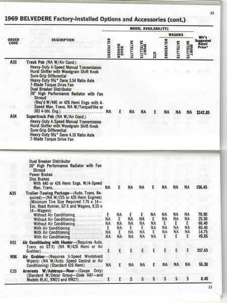

A/C compressor revs were an issue, and at least in 1969, Chrysler wouldn't put factory A/C in anything with a higher numerical rear axle ratio than 3.23.
That is an interesting idea. Can that be verified in writing by way of dealer special order forms or other Chrysler literature aimed at the consumer? Usually we can find "N/A" in the columns where an option is not available with certain models/options.
Here you go - part of the answer anyway:
A/C compressor revs were an issue, and at least in 1969, Chrysler wouldn't put factory A/C in anything with a higher numerical rear axle ratio than 3.23. I know because I asked our dealer what the ratio was in his factory air conditioned GTX , and he told me why it was a 3:23. With 440 GTXs and R/Ts, the 3:54 Dana rear came standard with the 4-speed, which meant no air conditioning. But you could get air with a Road Runner 383 4-speed, if you took the 3:23 rear, and no air grabber. As pointed out earlier, they were extremely rare birds.

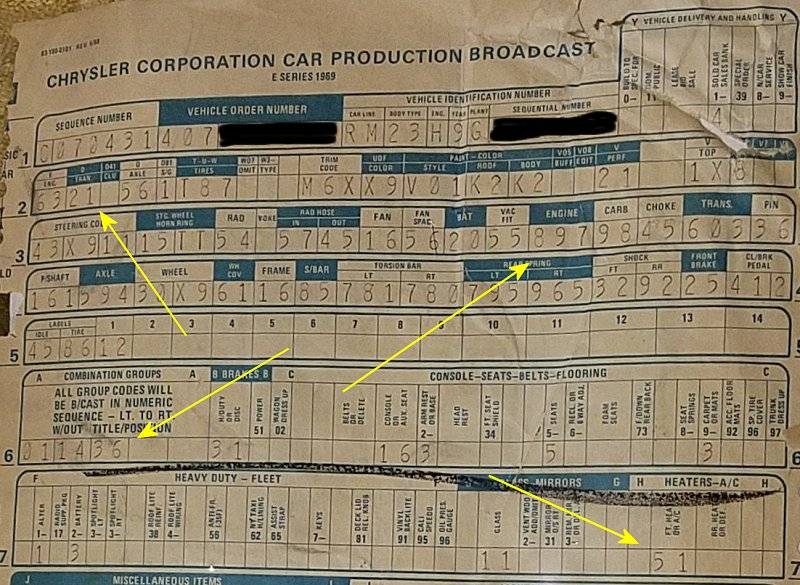

For 1969...there was no prohibition to 3:55 gears and A/C. One can find 383-4bbl four speed with 3:55 gears and A/C applications (rare...but they exist) as well as 440 automatic transmissions 3:55 gears and A/C. They are not common but the combination was not prohibited.
AFAIK...383 with A/C and manual transmission was never prohibited.
A 440 four speed with A/C was almost virtually prohibited (one exists).
As far as the over reving part that argument has not made sense to me.....Does a 383-4bbl 330 horse not rev as high as the 335 horse version? (69 B bodies with 383-4 and A/C got the 330 horse and not the 335). IF over revving and engine damage was the issue and warranty work costs were too high, then I think you would have seen a prohibition against A/C and four speeds.
To me...the most logical answer was stated above. Cost and application. The target buyers for RRs and Super Bees were young buyers with less money that wanted to go fast. A/C cost more and weighed more.
A36 with D21 and H51. Also notice the engine assembly is the 897 330 horse version.
