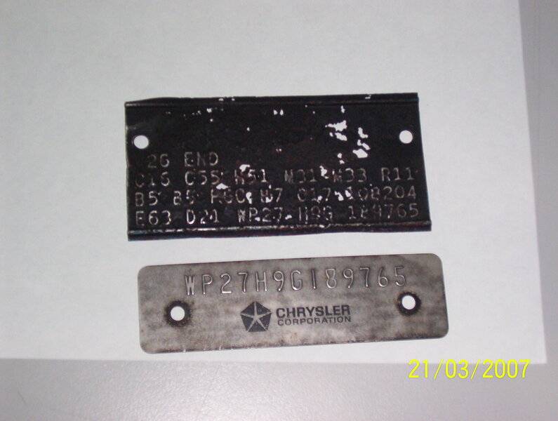

How can i determine if my car had a fan shroud from the factory? Is it possible without buildsheet?
