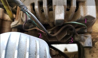

Which connector is the "field spade"? #2/purple lead? or #1/green lead?
Sorry, was thinking a pre '70 alternator with only one field spade... not your '74 now that I read your signature.
That wire at #2 doesn't look great in that blurry shot, so come back to it later if the alternator is good.
#1 is the ground side of your electronic voltage regulator and #2 is the power side. #3 is of course the main 12V stud to the battery.
SO... pull #1 and #2 off. Ground the #1 field spade and quickly jump #2 and #3 with a wire to see if the voltage jumps up to tell you that the alternator is at least good.
