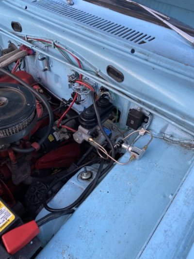

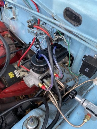

I bench bled a master cylinder today and found that while pushing the piston in and out, the front port got fluid first. For the first 1/3 of the piston travel, the rear port wasn't getting any pressure or bubbles.
The front port serves the rear brakes, the rear port serves the front brakes.
It seems odd that the rear would get pressure first. I always thought that master cylinders sent fluid equally to both ports at the same time.
Is this normal?
Secondly.....
I have read of people running brake lines in manners different than stock and leaving out a proportioning block or distribution block. I'm looking to do the same.
I plan to run the master cylinder REAR port to a T where it will feed the two front brake hard lines.
For the rear, I plan to use a simple "union" style fitting like shown below:
Does anyone see a problem by running the brake lines this way?

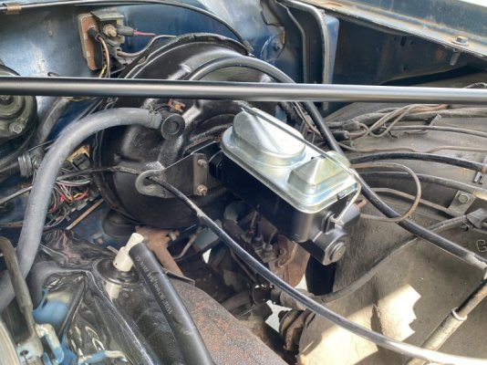

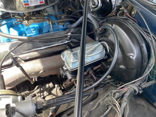

Today I lined up all the master cylinders that I have gathered....
Out of view is an aluminum 15/16" unit and the aluminum 1 1/8" MC on my car.
Three are cast iron 4 bolt units. One at 1" and two of them 15/16".....They all had 9/16" front ports, 1/2" rear ports and when bench bled, pushed fluid equally in time front and rear.
Two of the aluminum units were 1.03" and had 9/16" front, 1/2" rear ports and pushed fluid equally.

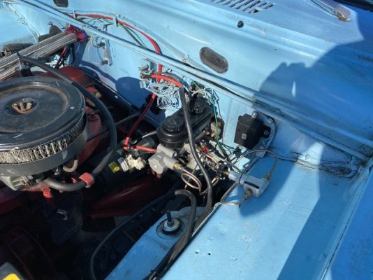

The final two MCs are the ones I've been working with lately. Both 15/16" and 1 1/8" units have identical ports and push fluid to the front reservoir first.
