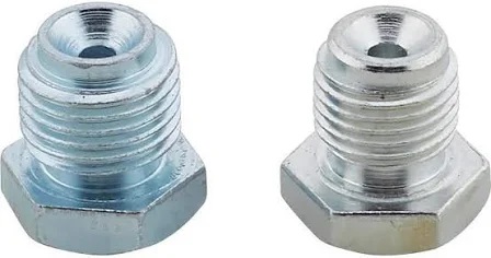

Hey guys, I'm looking at isolating my new dual master cylinder for some brake troubleshooting (very soft pedal) after several brake bleeds.
I like to plug the master first see if I got a defective master cylinder, if not than isolate front and rear to see if that may be an issue.
The problem I'm having is finding the 1/2-20inv & 9/16-20inv plugs. I can find 1/2-20 & 9/16-18 all day long (probably Chevy)!
Has anybody been able to locate our Mopar master cylinder plugs?
