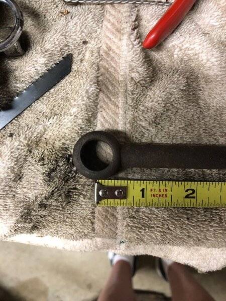

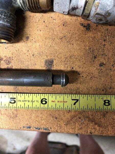

My 69 Charger had a single manual master cylinder.
Going back to the correct dual manual master.
Please see the pics of the single master rod and dimensions.
Would this be the same or different than the dual master?
If different, what length would I be looking for?
Thanks.
I've done 2 1966 single to dual conversions.
No changes just put the new master on it and they work fine.
Does the pictured rod look correct?
Just asking because the guy may have just grabbed something he had in his shop, back in the 70s. Thanks for the info.
A rubber piece goes on end to hold rod in master and anti rattle. There should be one in with new master, lube it so it slips on easier.
