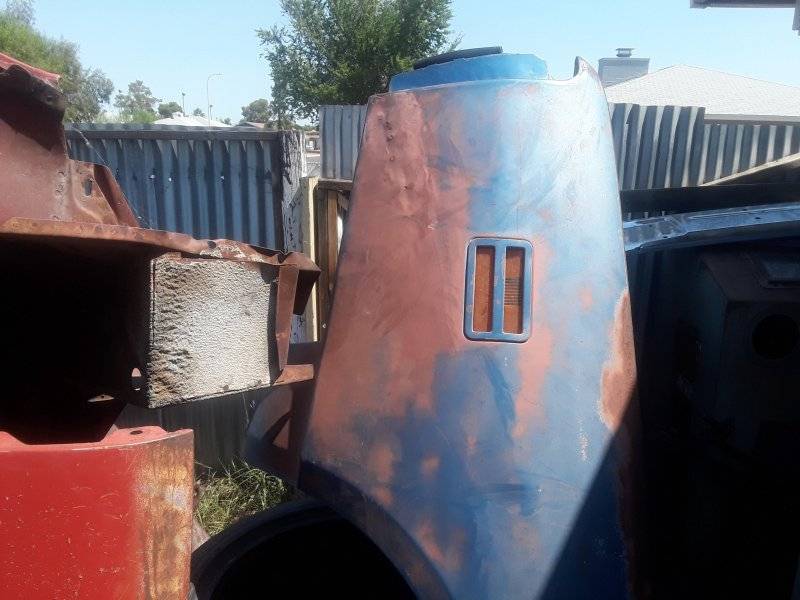

That absolutely helps, thank you.We've done this a few times at one of the shops I do work for. Cars that had cool patina but needed patching or small panel replacement. It's not an exact science so there's no set directions or guarantee on how to get it right 1st shot that I know of. It's an arts & crafts style trial-and-error thing sometimes. You can try a red oxide primer but you may have more luck finding a redish brown paint for matching the primer you have and you'll have to try several colors of blue before you find something that will dust on and look similar to your blue. To make the color match and not look like new paint we sprayed pretty dry and too far off to not get a shine, dusting it on. Then we used scuff pads by hand to cut through the paint to the "primer" and feather the edges out to look believable. You can try DA but you'll have a lot less control and more likely cut all the way through in spots. You just want to experiment with it and go slow. Hard to explain but I hope it helps.

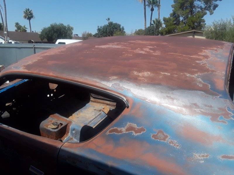

Patina is cool, but i would shoot it in a semi , or flat B5. I don't hate patina, but I can't get into it.I am building a 71 Charger that was originally B5, however now it has a red passenger fender, black (EDP) drivers side quarter skin, black (EDP) drivers side lower quarter patch and a EDP air grabber hood. I would like to try and match the existing faded B5 patina that is on the rest of the car if possible.
I am thinking that I would need to paint the red fender and EDP panels the same manner which the car was originally painted and then patina them is some fashion.
My other option is to just leave the mismatched panels as they are and roll with that which I would rather not do. The objective is to have the car look "field fresh" however it will have a new interior along with a new 5.7 Hemi and TKX trans. The engine compartment, interior and trunk will all be new and nice, I am going to paint the engine compartment with B5 as well probably inside the trunk and perhaps the door jams.
Just for clarity, I am not asking "if" I should do this I am asking for advice on "how" to do it.
