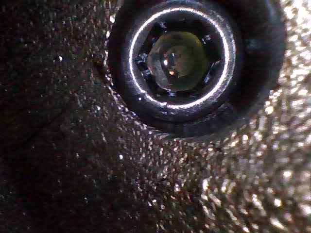

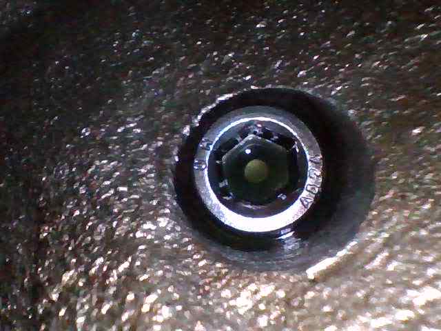

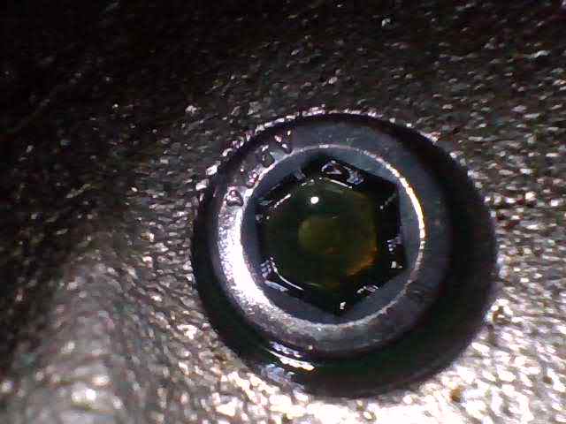

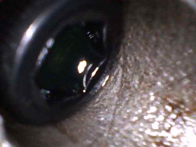

Here are a couple pics from the borescope of the interior intake manifold bolts and what is laying in them. Feels like fuel (maybe from the previous issues with the carbs but should have evaporated out). But does not really smell like fuel. Debating drying these out and then running engine again to see if it comes back before I pull the intake and valve covers?
I guess get some on a rag and see if it dries out. If it does not it has to be oil. It almost has to be coming up the bolt threads to do that as I think if the gasket was bad it would oil the intake port but not where you are showing in my opinion. Maybe pull one bolt and see if they sealed them, or an explosion cracked the bottom of the intake is my only other idea, not a good one. Grasping strings here.

OK I pulled one of the intake manifold plugs and took a look with the borescope.
The puddles are back at each bolt. Thanks for reminding me to check. I had blown them dry before this test drive.
Has an odd green tint at least in the borescope light but I stuck a q-tip in it and it is definitely fuel and not oil.
So it looks like I am back to the carbs again.
