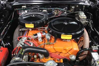

I have a max wedge tribute car with factory wedge crossram and two Carter 3705s. Carbs have been rebuilt and I am still way rich at idle (but this could be the 509 cam's low vacuum at idle). Mechanical fuel pump (factory style replacement) is putting out 6.5 lbs of pressure. Could that be too much for the Carters and if so does anyone know of a return-less regulator that can be installed on top the wedge manifold where the max wedge fuel lines run (2 lines, 2 filters, etc)? I don't really want to change the way the factory fuel lines are set up.

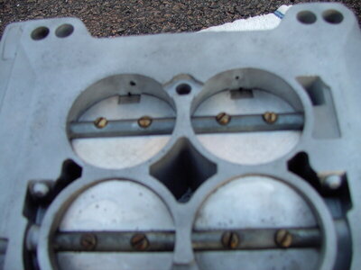

With 6" of vacuum & a cross ram intake that produces a poor low speed signal, I would expect those carbs would be idling off the transfer slot [ pri t/blades opened too far ]. This will cause a rich idle. Another symptom would be idle mixture screws screwed all the way in &/or mixture screws have little or no control over idle.

I will pull the carbs again today and take pics of the transfer slot exposure the way it is now with it idling at 1000 RPM and 18 degrees initial timing. From what I saw when I rebuilt the carbs it has been running way rich for a very long time. Previous owner had idle cranked up to 1500 rpms.
OK pic is blurry but definitely too much transfer slot exposed at idle. Over an eighth of an inch, not square. Both carbs are like this. Other than drilling holes in primaries what other options are there? Thanks
