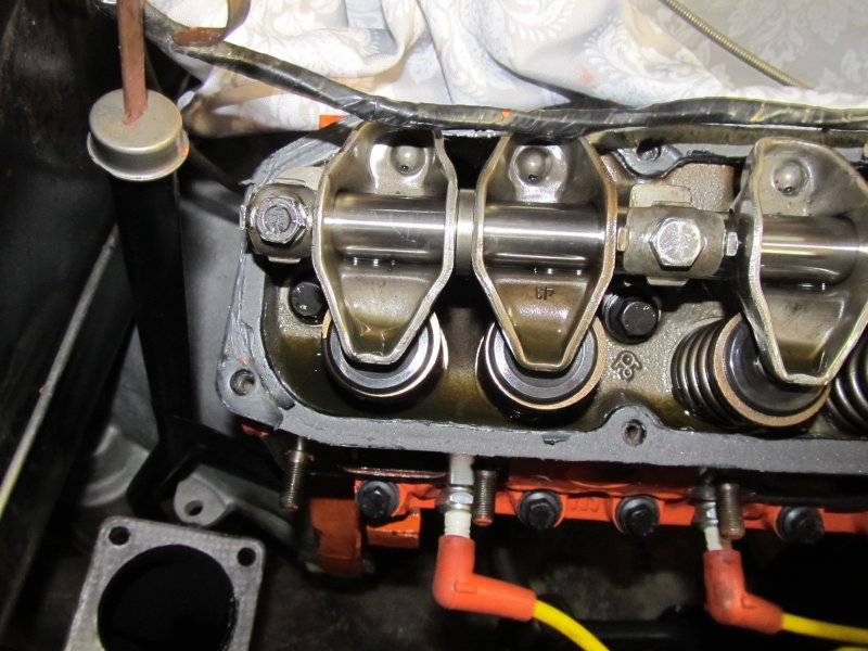

Is the engine raised higher in the front? After the heads get back swap them side to side then see if #1 gets the oil or if it does the same wicking on #8.This is where the oil sits in the valve cover. Valve cover gasket is not leaking, new exhaust manifold gaskets from mancini racing
Wonder why #7 isn’t doing the same thing?
