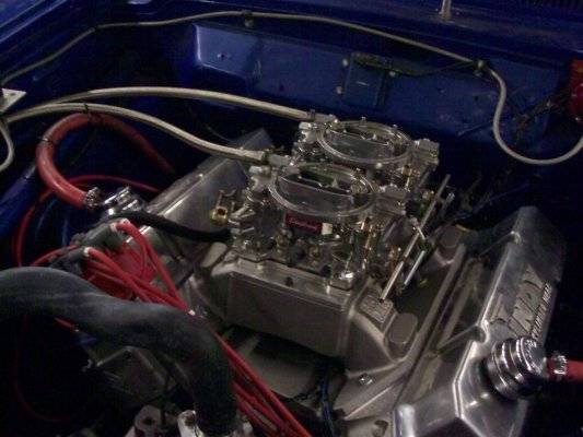

My brother runs a ModMan intake on the 511 in his 64 but he runs 2 Eddy carbs. His 64 has run 9.96 best with it. He has not had any other intake on the eng yet to compare it to. Ron
