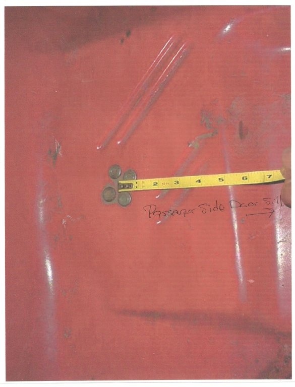

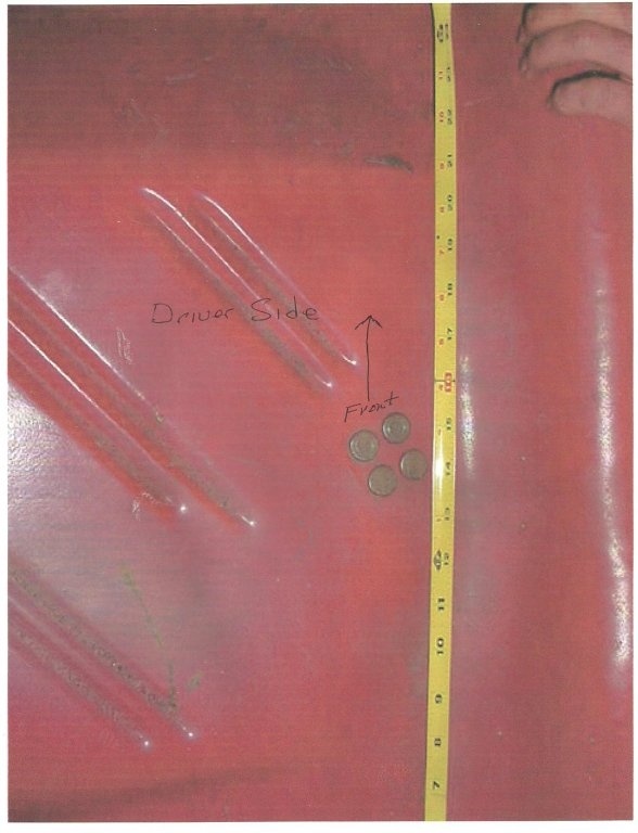

Plymouth welded,I have a picture of the exact location,if I can find it I'll post it.
Hope you can figure this out,first and second give measurements from driver side door sill and front of floor pan,third picture is front passenger side sill to bracket mounting.If you relate the bracket mounting to the floor pan ribs,it will work out.Notice the bracket mounting is angled,that is how the holes need to be drilled.
