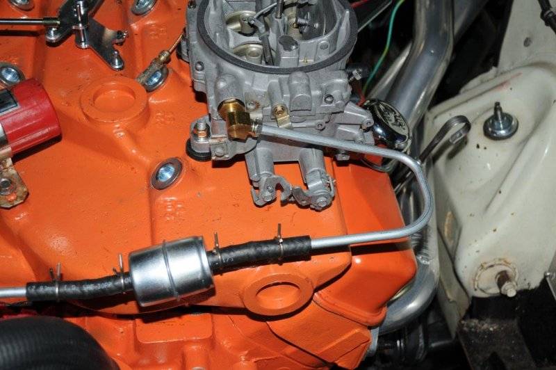

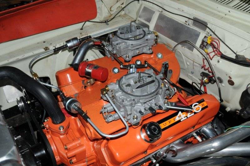

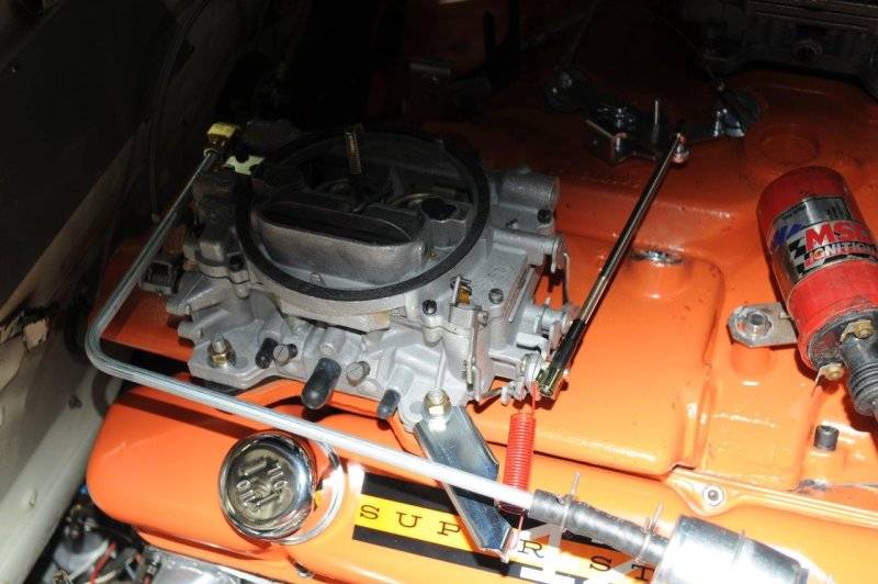

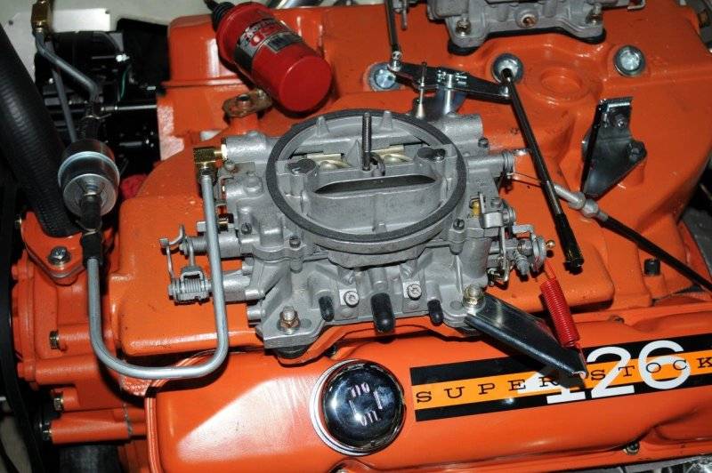

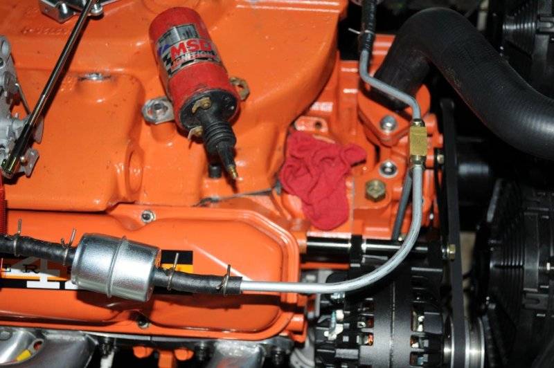

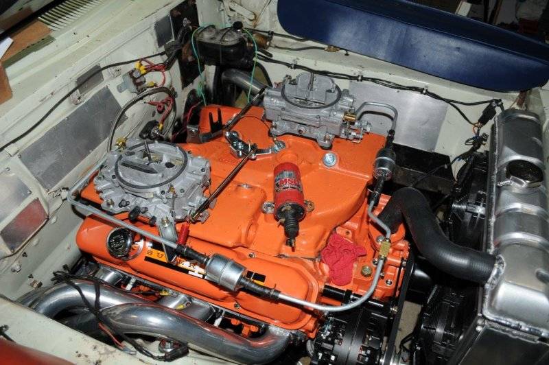

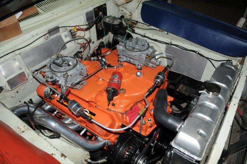

Finally got the fuel system sorted out. The correct Fine Lines Kit ($74.07 + shipping) is: Part Number RPC6203OM (62-63 Mopar B-Body 413/426CID Wedge, w/ Edelbrock Dual 4BBL Carbs, X-Ram, Pump to Carbs Fuel Line Set; Steel). This is the correct set to use when you are running Edelbrock 1400 series, in my case I'm using 600 cfm 1405's for now but if I go with 750's or 800's it'll be plug and play. No directions come with the sets from Fine Lines, so I took pics to assist anyone else going this route. The factory 3447's & 3705's are too expensive for me; if my car was an original MW car, it would be worth it.

This is the setup:
- A&A PN# MWCFF-2: Max Wedge Carb Fuel Fittings with Small Filters and 90 degree Elbows for 3705 and Most After Market Carter and Edelbrock Carbs (Pair)
- A&A PN#MWMK: master crossram linkage kit. You'll have to open up the carb ball stud holes a bit to get them to mount, just slightly undersize.
- Fine Lines PN#: 62-63 Mopar B-Body 413/426CID Wedge, w/ Edelbrock Dual 4BBL Carbs, X-Ram, Pump to Carbs Fuel Line Set; Steel
- I use a PB auto with a RMVB so I don't need a kickdown provision. If you're using the same or a manual, you'll need to trim the Edelbrock carb linkage kickdown mount because it hits the cross ram top. See this thread, post 144. The return of MAXIMVS...
