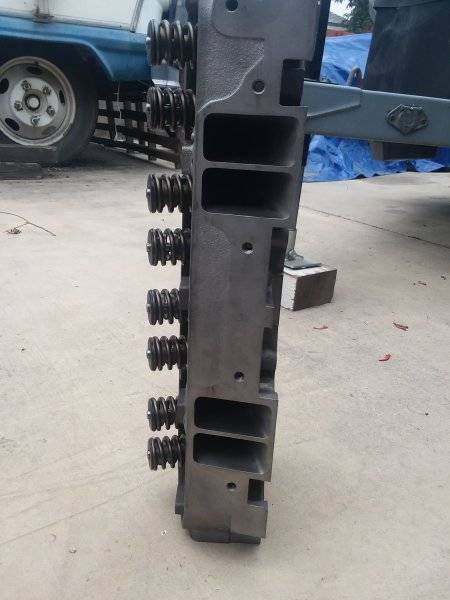

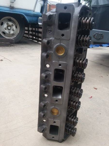

These flow right at 330. Professionally ported years ago, refreshed at IMM.
Thanks for the replies. 330 cfm is impressive for that old iron head. If they got that flow out of it in the 60s, that would be a superior head.
